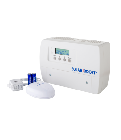

Or an eddi etc
Thanks for your replies.
I am fully aware of the benefits of a Solar Immersion Diverter and would be looking to use one (or two) in the system.
