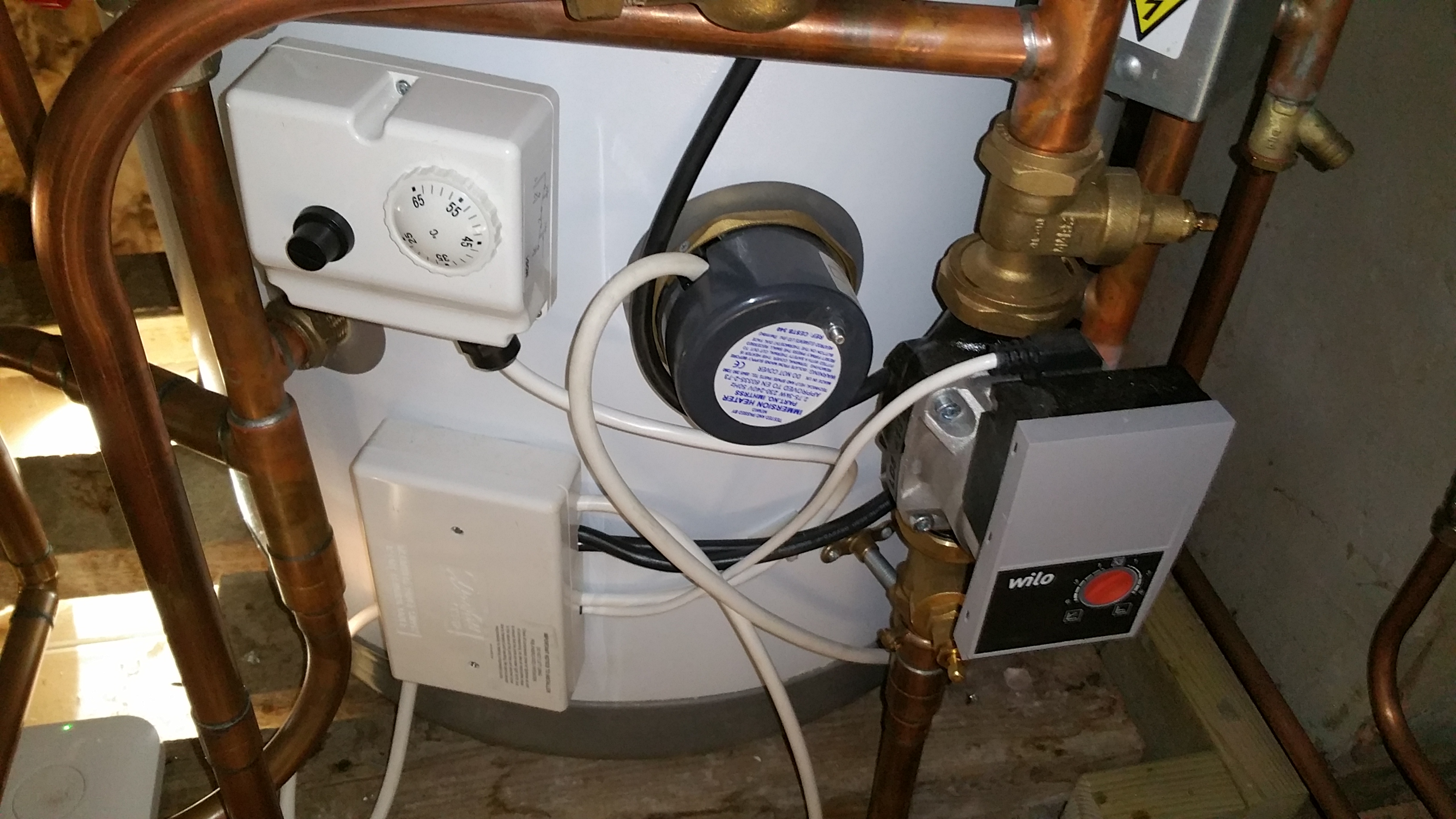

    Thank you so much for the replies! I am creating a checklist of things for him to tick off today based on your suggestions. Here are some pics 20170523_080532.jpg 20170523_080452.jpg 20170523_080417.jpg 20170523_080402.jpg

    Doesn't look terrible to be honest although I don't like seeing electrical boxes such as the NEST controller underneath pipework really.
    It just needs someone with a good understanding of heating controls electrics (not something all heating engineers have sadly) and how to faultfind them.
    Shouldn't be a hard one to faultfind though for a competent heating installer.

    That's what makes me think it is a wiring issue. He was very proud of the installation and I am impressed with how neat it was and him personally but as soon as we got to the wiring part it all went wrong and the confidence left the building.

    From the photos, it looks as though the data label on the tank hasn't been filled in. That is not a good sign IMO. Is your plumber G3 qualified?

    Is the pipework being insulated by him or yourself?

    I take he should be filling it in then? Is it a statutory requirement to fill it in and be G3 certified (just so I know when mentioning it) Should they be insulated then? I'll get on to him

    Only people with a current G3 competency qualification can work on unvented systems. Competency is normally demonstrated membership of a recognised scheme (Gas Safe is the best-known but there are others) and a scheme-issued ID card that explicitly confirms the type of work covered.
    Filling in the data label is an installation requirement. Without it I think you'll have difficulty making warranty claims or proving the system was installed by a competent person.
    Legal responsibility for the safety of such systems and their registration with the local authority building control dept rests with the owner, but this is normally discharged if the system was installed by and has been maintained by an appropriate scheme member.
    As others have commented, the pipework looks okay, but a job isn't finished until it's been proved to be working correctly and the paperwork is done. Your installer probably just needs to get the electrician they normally work with in to sort the controls out.

    It looks like the install has been fitted in an uninsulated space, i.e. a loft. If this is the case then all pipes containing water must be insulated yes. Did they discuss this with you before hand? We often do with our customers as some people are happy to fit the installation themselves to save them being charged plumbing rates for what's a very easy job.
