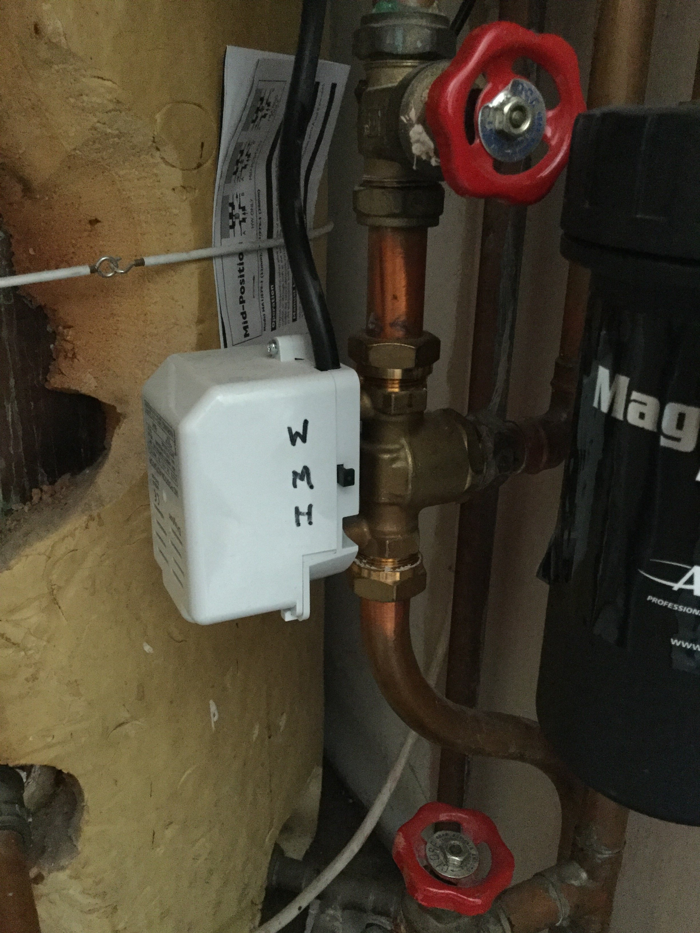

    Hi, I’ve had a problem recently since I moved the pipes to my radiator from one side of the room to the other (in a bungalow so pipes go through ceiling into loft).
    Even with the CH turned off I still get hot flow pipes to all radiators, the rads are just slightly warm at the top & all return pipes are cold. In this warm spell I’ve had to turn off all the rad valves on the flow side to get rid of the heat out of the pipes, but as soon as I open them the flow pipes heat up again. I have a standard oil boiler & 3 port motorised valve in my system if that helps for any info. Thanks in advance for any help.

    Sounds like your 3 port valve is faulty (Letting By) depending on age may be better to replace complete valve, as it could be the motor or the body that is at fault, but get it tested first as other controls could be causing the fault, Controller, Room stat,

    ok, I’ve been in the loft & traced out the pipework & im connected correctly with flow/return. I thought it may be the motor in the valve so replaced that (cheap option as was only a tenner) but problem still the same. I have recently installed a new Salus IT500 thermostat. I’m now wondering if it may be the valve not quite operating fully & is passing as suggested.

    These 3-port valves can give problems, mine is a Honeywell clone, with a rubber ball on a lever, covering either of the ports, don't know if yours works same way. Had one where the lever broke off the shaft, another where the shaft through the ball fell out - poor design, just threaded in. I put Loctite on it and rivetted the end over, then I got symptoms like yours. I had to bend the arm slightly to cure it, took several tries and was a pita. It might be worth dismantling yours and see if it gives any clues.

    as i said earlier just turn off the rad you repiped and leave the rest on. if prob goes away youve got your return wrong on your repiping. why are you taking out the 3 port. just start everything from cold with hot water on only and feel the heating pipe as far away from the 3 port as you possibly can, youll soon know bif 3 port is letting by

    With the repiped rad switched off (fow & return), CH turned off, just the hot water on, the flow pipes to every other rad in the bungalow heated up inside 10mins. So do you think the next step is the valve passing?
