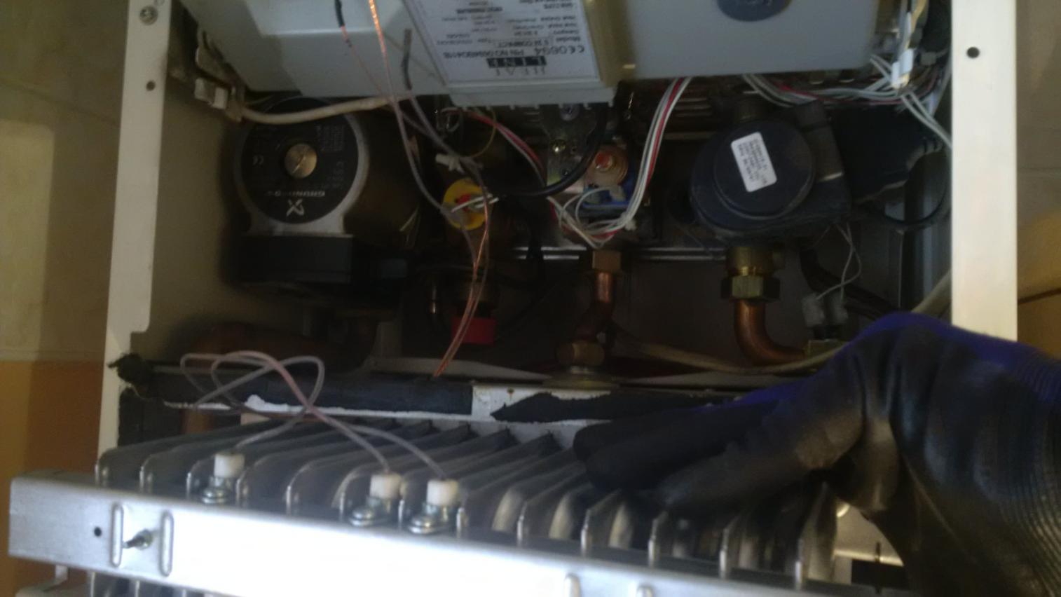

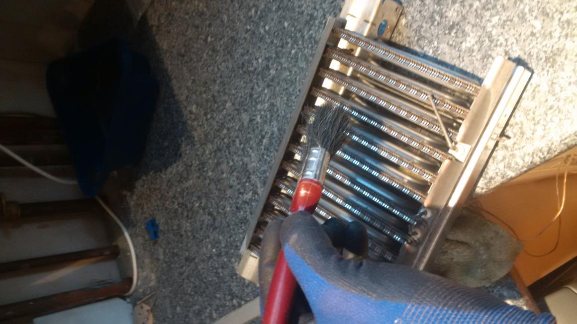

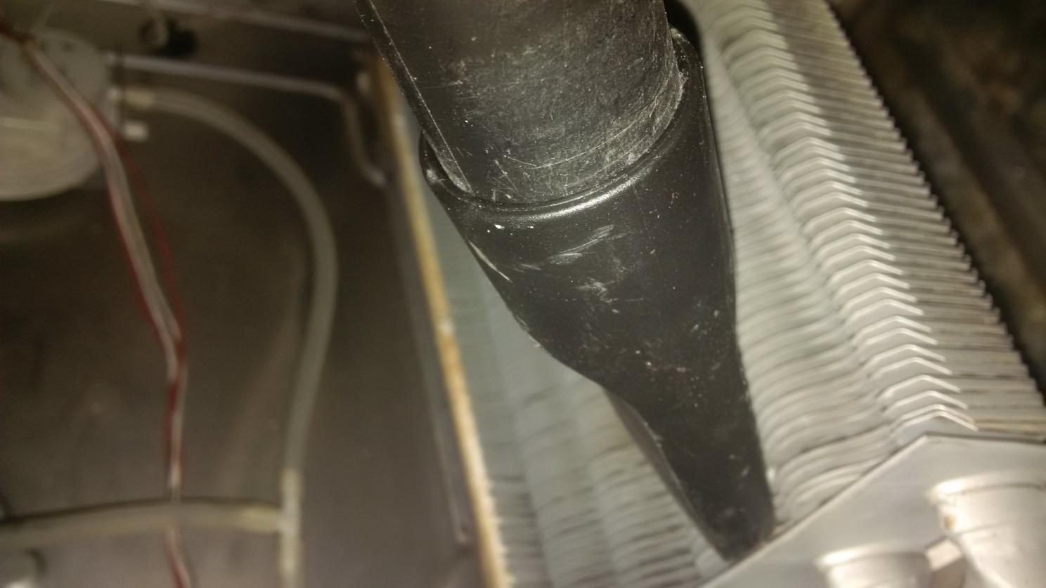

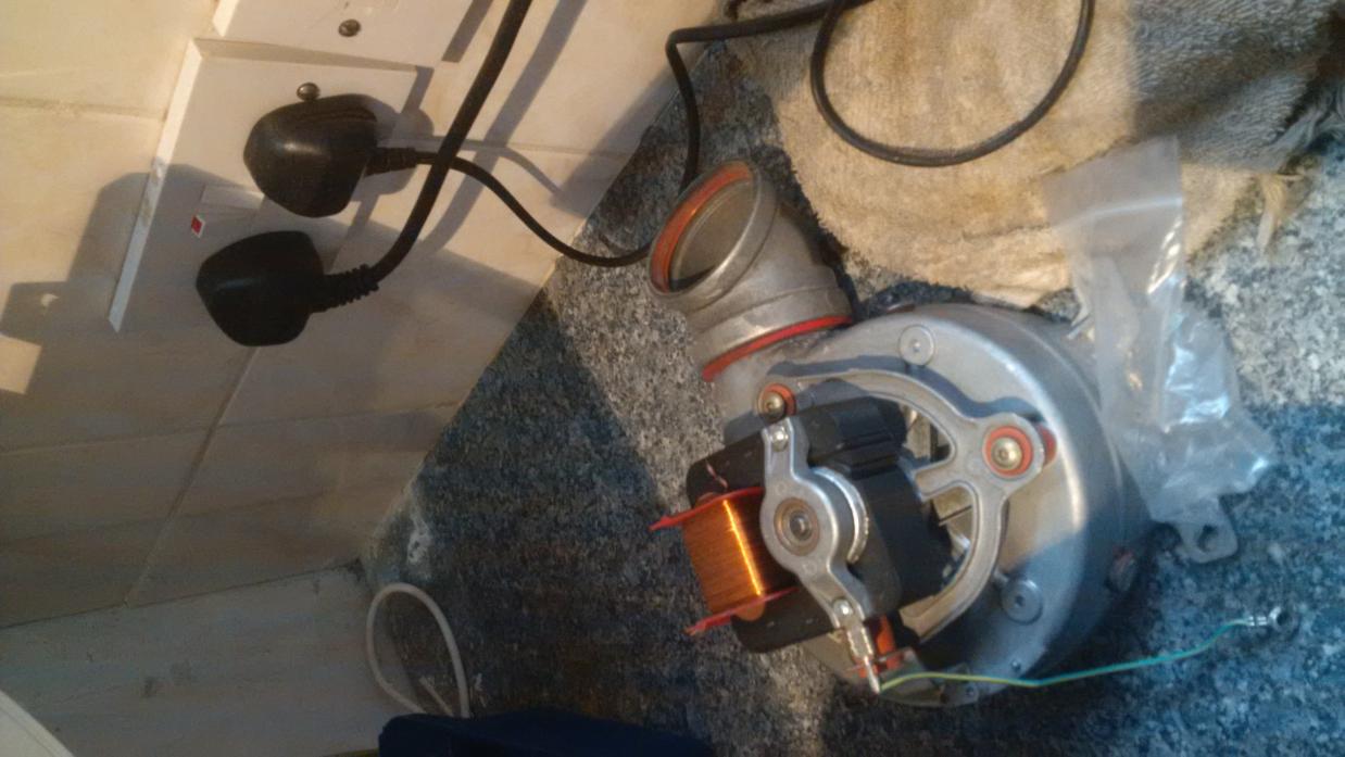

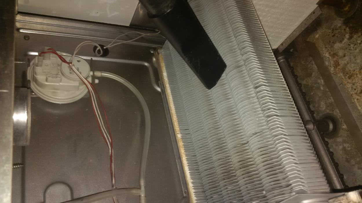

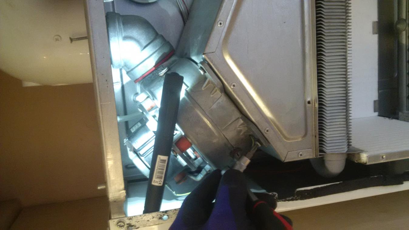

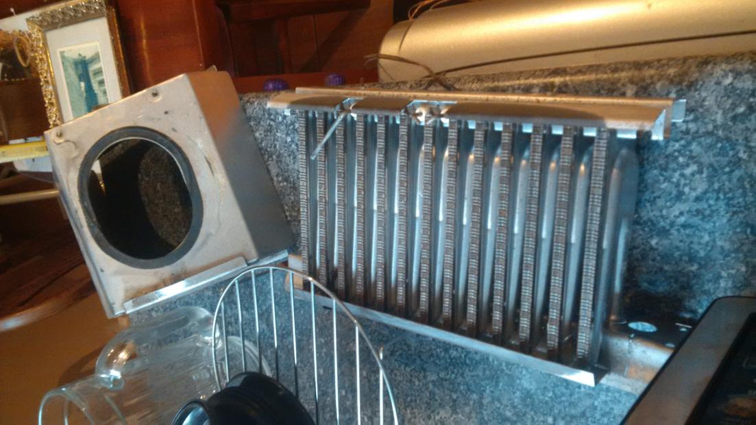

IMG_20160206_120914.jpgIMG_20160206_111904.jpgIMG_20160206_111858.jpgIMG_20160206_111821.jpgIMG_20160206_123603.jpgIMG_20160206_123217.jpgIMG_20160206_122538.jpgRight back to the UKPF and the "HEAT LINE S24 " spent 3 hours completely stripped cleaned. Sorted out the water leaking from the primary flow and return pipe to heat exchanger
Went outside popped probe into flu..
M Kane 455 went berserk with "HIGH co2"
Just after stripping and full clean up..
Had to tell the owner to assist a co detector.
Went screwfix and got one for £29.99.
Fitted it but explained the boiler is "AR"
And switched off
Got ticket signed.
Hate days like these :0 (
What I can't understand was why the burner pressure was reading 12.5mbars. And in MI's says 12.7mbars and blew out such high ratio.???
