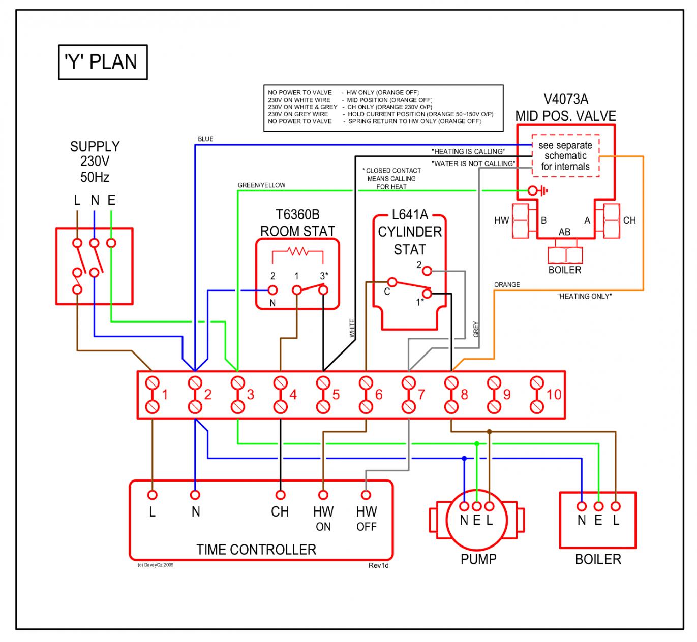

i am crap with the wires on the terminal blocks just looks like a birds nest, what am i looking for to add the brown and white too ? would it go to the programmer ? sorry for the lame questions or where should it be going ?
black wire
Blue is a neutral
Brown/white goes in with ch on or return from room stat if there is one
Orange goes in with hw off and sat from stat
Grey goes in with pump boiler and cyl stat call
