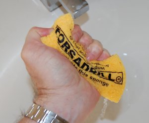

1) Use water cooling
We provide a water cooling sponge if needs be.
