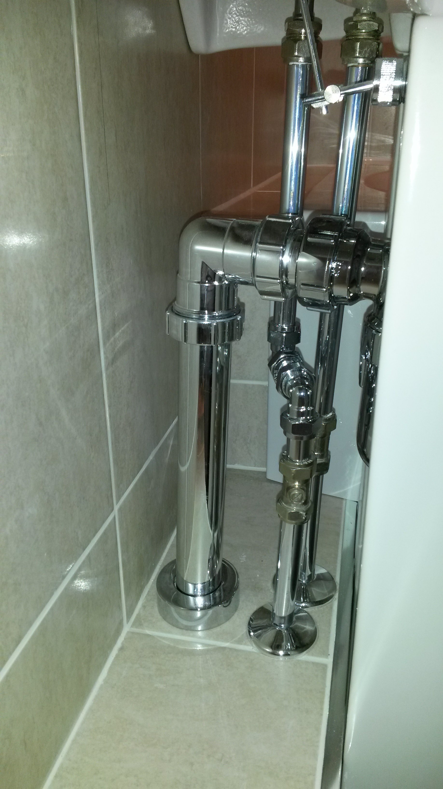

Are the pipes on show at all or well concealed by a pedestal? I recently did my bathroom but as we had a good view of them when taking a bath i did them like this -

Are the pipes on show at all or well concealed by a pedestal? I recently did my bathroom but as we had a good view of them when taking a bath i did them like this - View attachment 30437
This is an awesome thing to do mate. But what I will say is that there are a lot of fittings there if you are a confident diyer for next time I would solder the elbows onto the chrome. Or bend the pipes with a pipe bender
I only found out about chrome solder fittings a few weeks back when i posted a pic of a rad i put in my kitchen with chrome pipework. Not sure i fancy stripping back the chrome on every joint though for the solder. if youre not spot on you would have a poorly soldered joint or exposed copper past the fitting where its been stripped too far back.
I have got a bender but am still very much the beginner with it. I found some measurements on line to aid in getting the bend just where you want it so will try that next time i need it. Also have the Rothenburger Quickfire 2, sooo much better control than the amatuer torch i had before.

Not really. No one's given bad advice as far as I can see. The pipework coming into the room from the floor looks messy, but you can only work with what's there. You could solder onto the tails coming from the floor using strategic pipe bending to bring the rest of the pipe up to plumb, clip to the wall, and pull offsets into straight tap connectors. Or use bent tap connectors and go into them with pulled bends at 90Ā°. But if it isn't visible and it isn't leaking and you don't care that it isn't pretty, it actually doesn't matter very much.
Half turning off quarter turn isolators to balance flow is something I have done before I learned better, but as long as you aware that the isolator will probably seize or leak when you use it, it's not the end of the world.
I do have an unusual opinion on isolators below taps and it is that since isolators need to be used once a year to avoid seizing, and that they are there for maintenance purposes, and that maintenance of a tap is a rare event, probably once every five years on average, and that plumbing work is generally carried out by a plumber who can cap off to provide a temporary supply if need be, they aren't essential. I have met some other plumbers who say that very often they use them to replace a tap and half the time end up having to replace the isolator as well, thus having to isolate the entire system anyway, plus extra time and cost. Most other plumbers disagree with me, but I give people the option and have had customers who say that unless they are a strict legal requirement, they don't want to pay for them (and I won't buy cheap and nasty valves, so the costs add up) and, in these cases, I don't fit them.
Going back to the OP's question, if that's speedfit or similar pipe coming into the room (is it?) connected to copper above, I would buy some new speedfit isolators (or couplings) and continue the run in plastic right up to the taps and use speedfit tap connectors to go onto the tap threads. If you really just want to do the minimum and the taps don't line up with the hot and cold pipes, you could always use flexible tap connectors that compression fit (or pushfit even!) onto the copper pipe.
