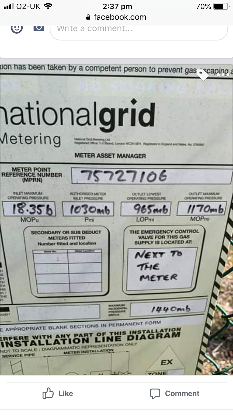

Thought of this thread when I saw this :D
They'll be cooking more than few steaks there ^^^^ then.
Bread maybe?
Grain dryer it was, high pressure set up scented onsite
