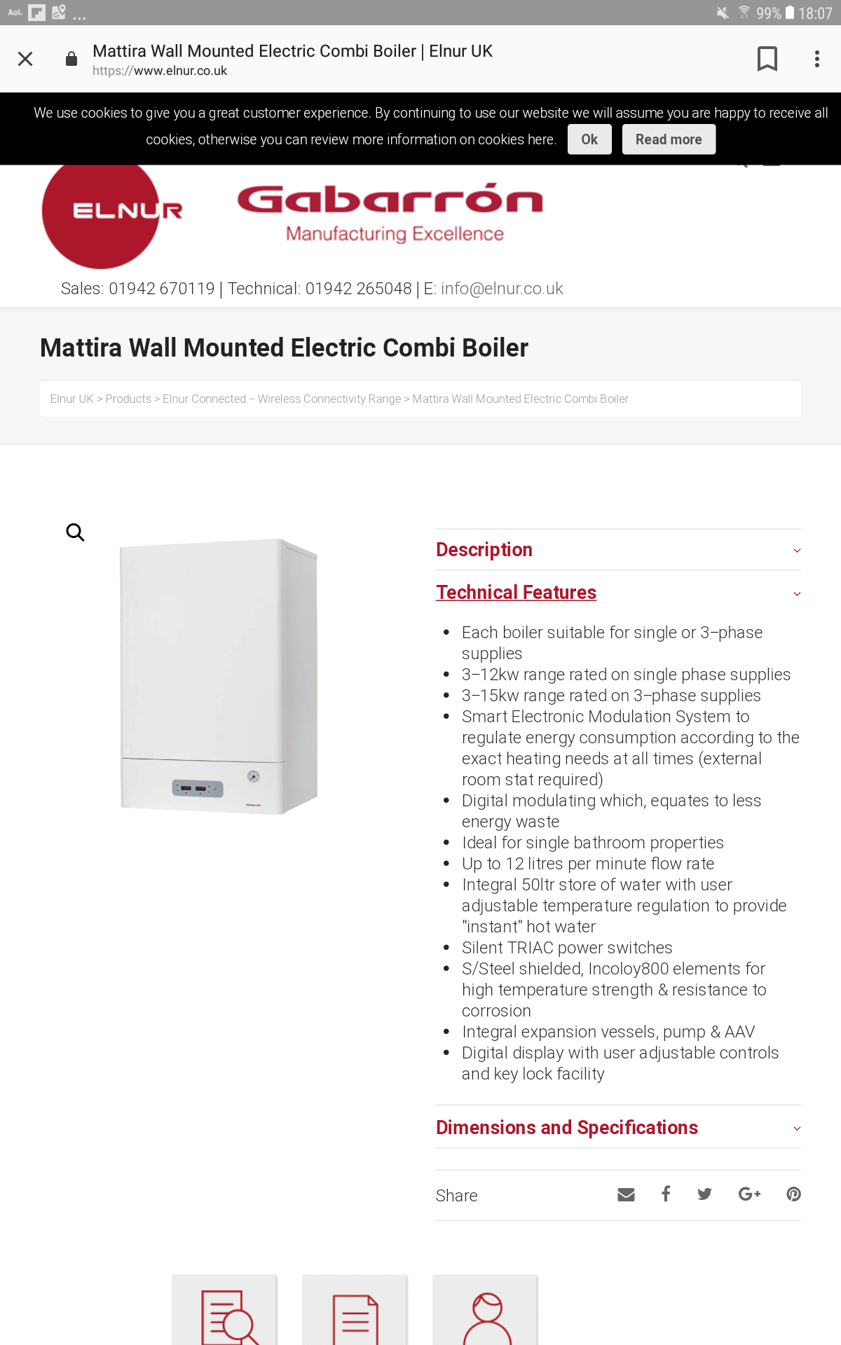

Do you think the boiler would provide enough hot water and heating to a property this size? The boiler spec says 'ideal for single bathroom properties'. We are a young family of three so it is unlikely that both bathrooms will be used at the same time unless we have guests. We are the first people to buy the property after the renovation therefore not even the seller has an idea about how good or bad the system is.

Yes you will be ok for showering you have 50 litre store built in I believe found this for you.cheers kop
