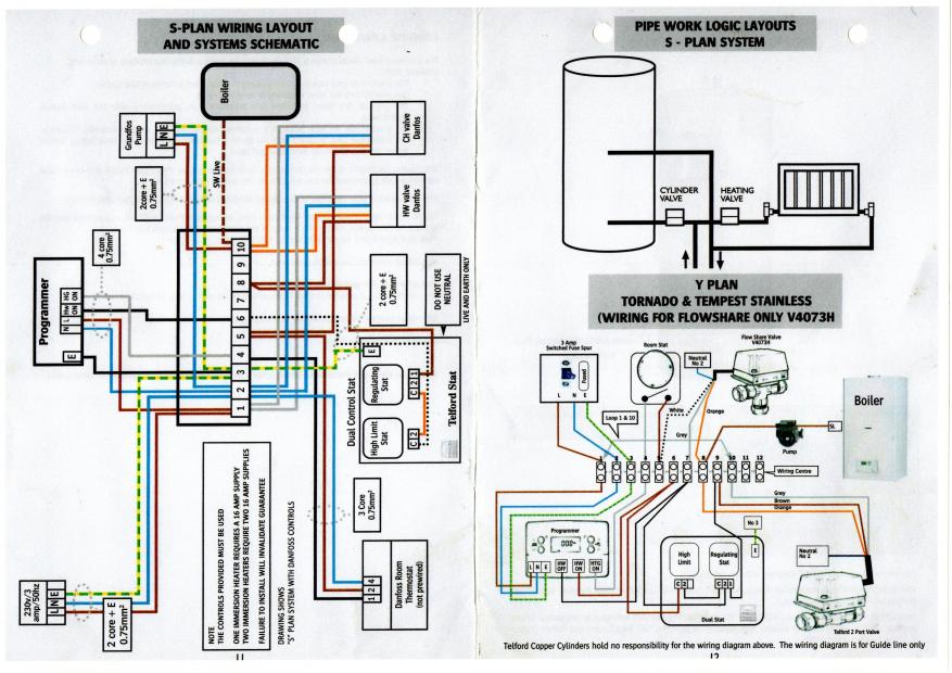

Anyone got wiring plans for unvented ?

While many systems are wired according to a standard wiring plan, many are not! There's no shame in using a pen and paper to write down what each wire does and where it goes. Sometimes wires are connected in a remote location and different colours are used. Sometimes electricians avoid these systems and ask a plumber to sort it out. If they do tackle the system, even they have to work out what all the wires are doing.

By following a wiring diagram, you can see what should be live and not by turning the thermostat up/down as needed. For example, joining the main 240v input live with the orange wire will produce 0v unless the heating/hot water is calling for electricity in which case it will show 240v.
My coffee’s gone cold.
oops now im doing it ive omitted the statactually yove got that wrong on most system its mains -clock-motorised valve then either pump/boiler or both
