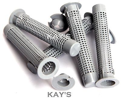

If you can get into the solid part of the brease block should be ok but if you hit a hole plugs won’t do
Longevity, plugs won't do the trick.
And your only using 40mm plugs. Depending on whats on the wall surface of the bathroom, you may only be doing into the blocks by 25mm.
Drill some descent depth holes and use Resin or Chemset to fix allthread into the wall and fix the brackets to that.
With Chemset, I doubt you will need more than 2 fixings in each bracket.
At least with Chemset, when the basin falls off the wall it will bring the blocks with it.
