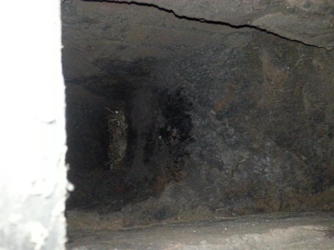

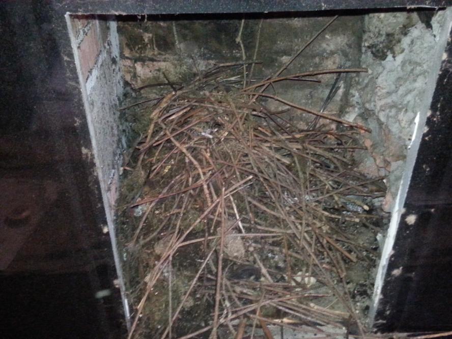

Went to service a Inset gas fire today, customers booked me in last week. Said it ''smells funny'' when lit.
Turns out the flue/chimney was completely blocked with debris. Fishy thing is they got a bird cage on their pot(next door hasent though), its a terraced house where two properties share a stack, next door has no fire. Chimney sweep booked, fire capped off as ID. I suspect the partition between the two chimneys in the stack has broken & some gremlins have set up shop in the chimney probably due to the damp weather and abundance of food after mid-night.
Fire had not been serviced in 10 years!!!!! They had a lucky escape I think!

The CO detector was well out of date with no batteries - needless to say I sent her for a trot down the shops to get a new one. I cant believe people sometimes!
