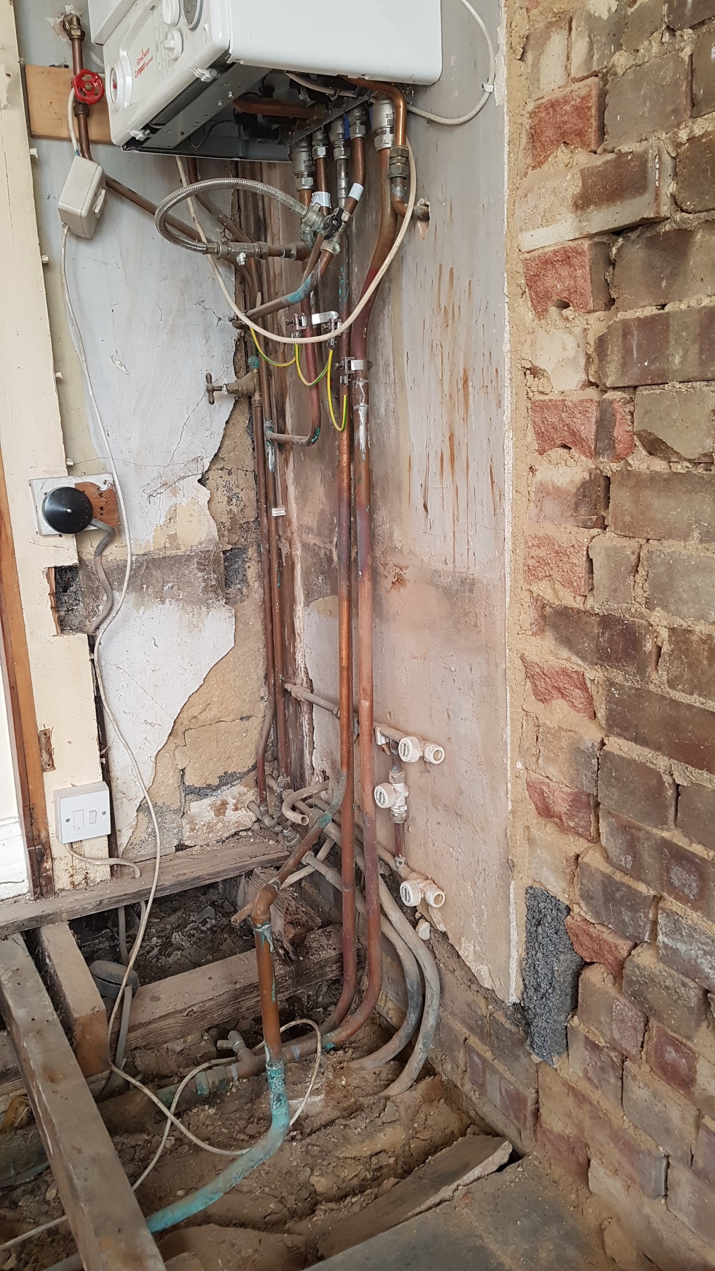

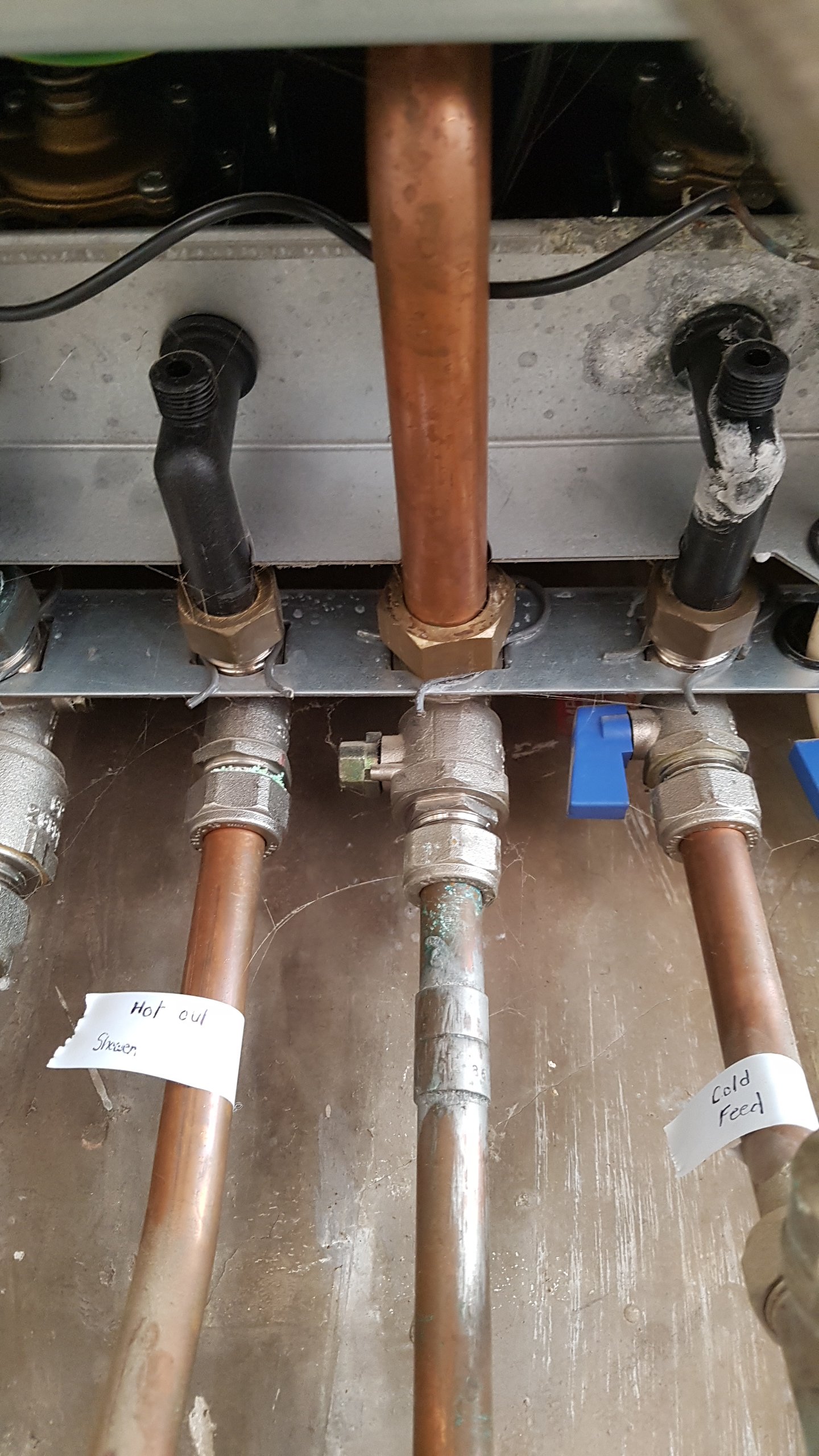

Thanks for the replies, i've added a couple of photos to hopefully shed a bit more light on the matter
The boiler is a glowworm combi
That pipework looks a right mess. But it does look like the connector onto the boiler is 15mm which means it is ok. When yor gas Engineer changes the pipework and makes it neater. I would extend the 22mm gas pipe almost right up to the boiler. But thats just me.
Yep - one of those lead pipes looks like a hot service to somewhere?, you'll be losing a lot of heat in the lead and to the ground where it's covered in soil :eek:
