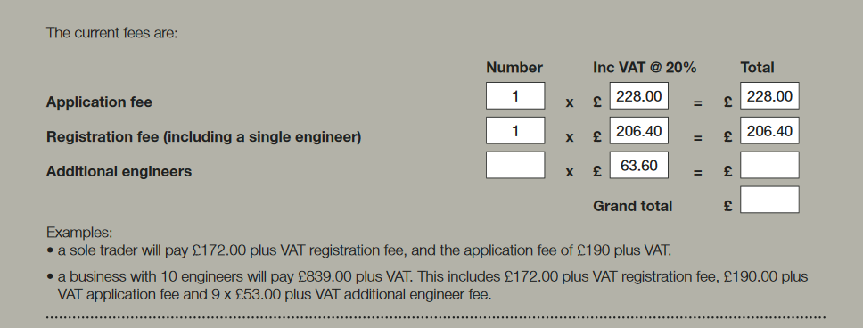

£63.60 per engineer.

But it will cost you as per my screenshot above
£434.40
