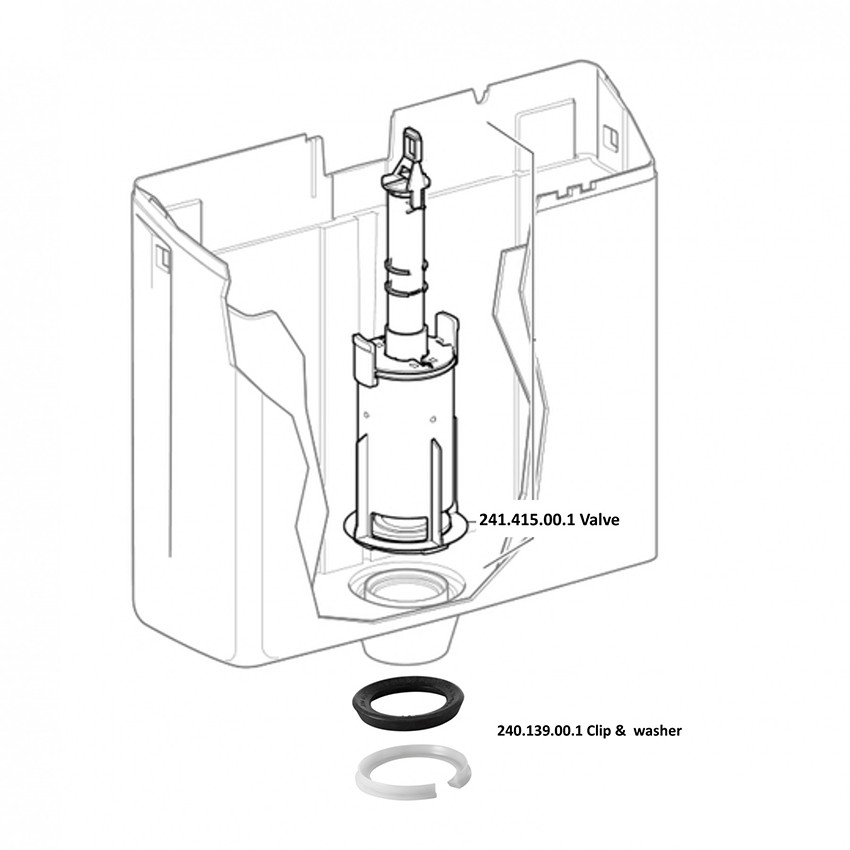

Here's the diagram:-
Appologies I thought the meant the inner seal , I think you will have to lift the cistern upwards , obviously disconect the water supply unless its plastic and you may have a bit of slack in the pipe , but leave the pan in situ .
Sometimes the flush pipe can be removed but I note yours is very close fitting so as above.
Thanks (that's what thought) but my first problem is how to release the rubber seal & clip. Do I need to prise the clip away from the boss somehow? With the pan and cistern in situ, I would be working blind so that could be tricky. Or can I just give the pipe a good tug downwards? Or is there another way?
First of I`ve never had to touch one but looking at the picture I`m thinking the pipe will disconnect leaving the rest in the cistern. Might use a smear of silicone grease putting it back together?

I had a similar issue. The easiest option was to unscrew the cistern and lift it out. . The pipe can be pulled out from the cistern as its a push fitting, and then you can access the rubber seal by pulling out the semi circular clip. Quite easy. The harder part was reinstalling and reconnecting everything with limited access
Where the elbow pipe is short, the easiest option is unscrew and lift out the cistern. It is a push fit into the elbow flush pipe. Then you can remove the rubber seal and clean it (if thats the leak) after removing the plastic clip.
