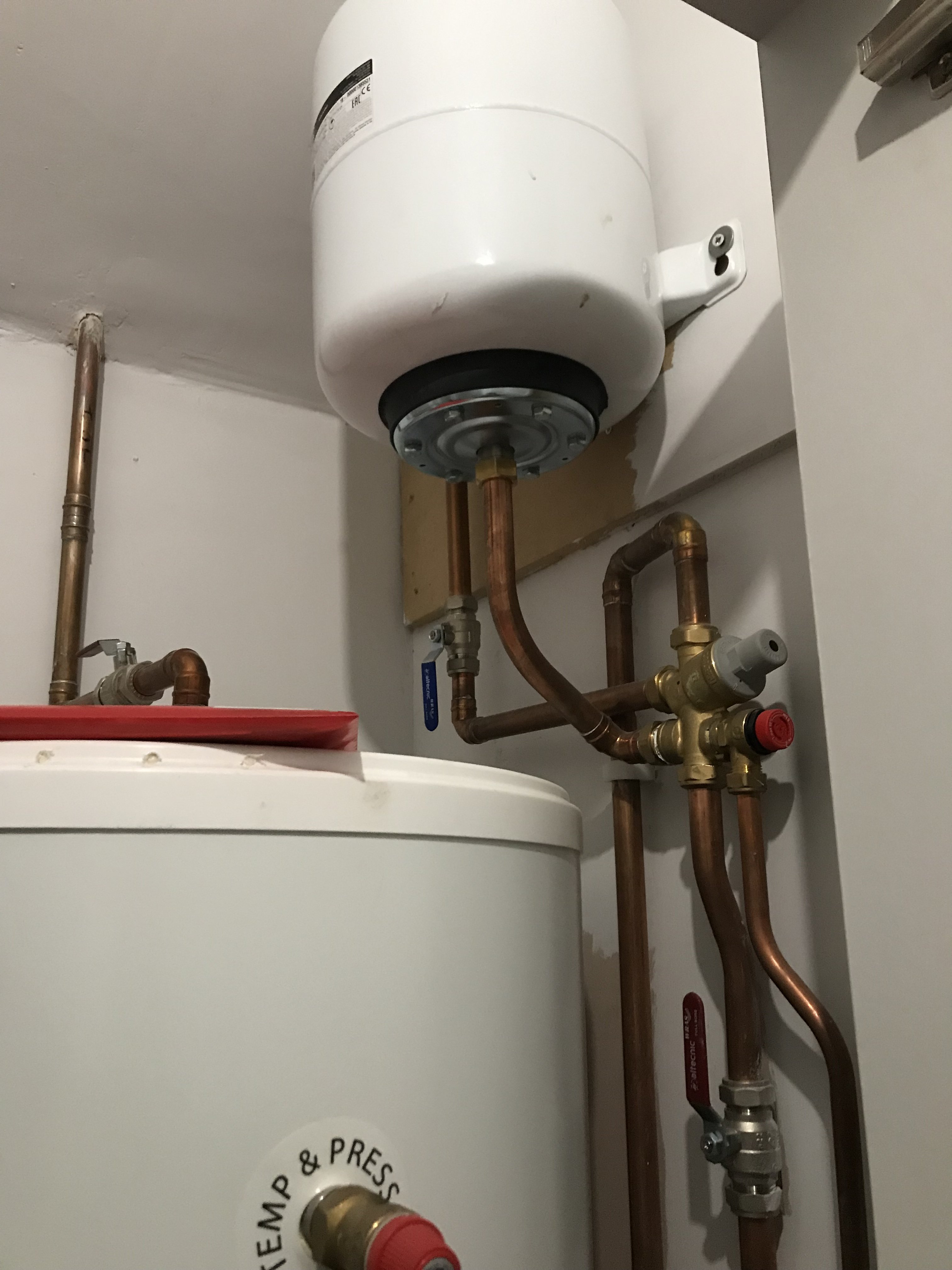

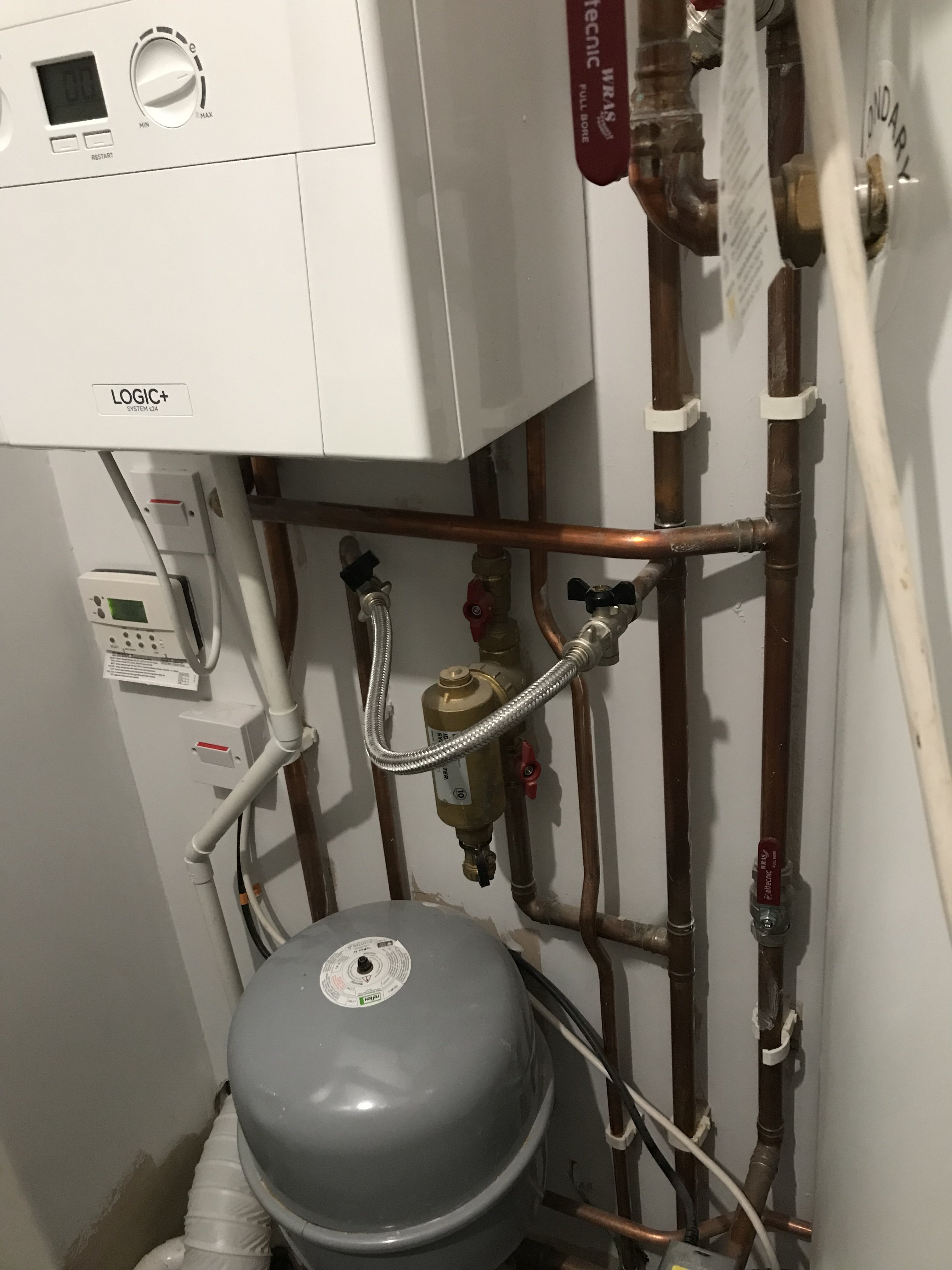

Do you have an additional red expansion vessel on the system or is it just the one in the boiler ?

I have attached a pic of the tanks/vessels already fitted but no red ones?

Grey vessel is the additional heating so good (most are red, sorry)

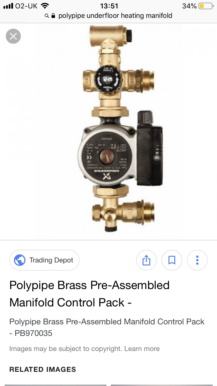

Photos of each manifold might help.

Pictures of the manifolds as requested. The pipe work coming from the boiler to feed these is 22mm copper BUT to the 9 port manifold where it goes into the ceiling there is a section of plastic speedfit on the flow/return which I understand has quite a significant reduction in bore (which, if the fault is caused by the feed to the manifolds being compromised then this will only serve to exaggerate this issue?)
