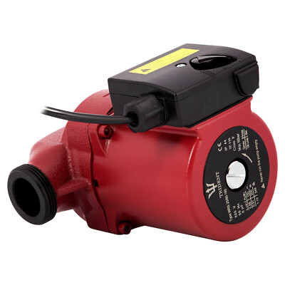

Screwfix don’t stock Trident pumps ? Also they don’t stock upm3

I don't have a curve for the Trident pump.

Good bad or indifferent I just bought a Trident 25/80 180 pump. Cheap enough to test anyway. If I'm wrong then so be it can set on garage shelf! Will be a pain to drain system again to open up pump from 130 to 180 but space to do it.
