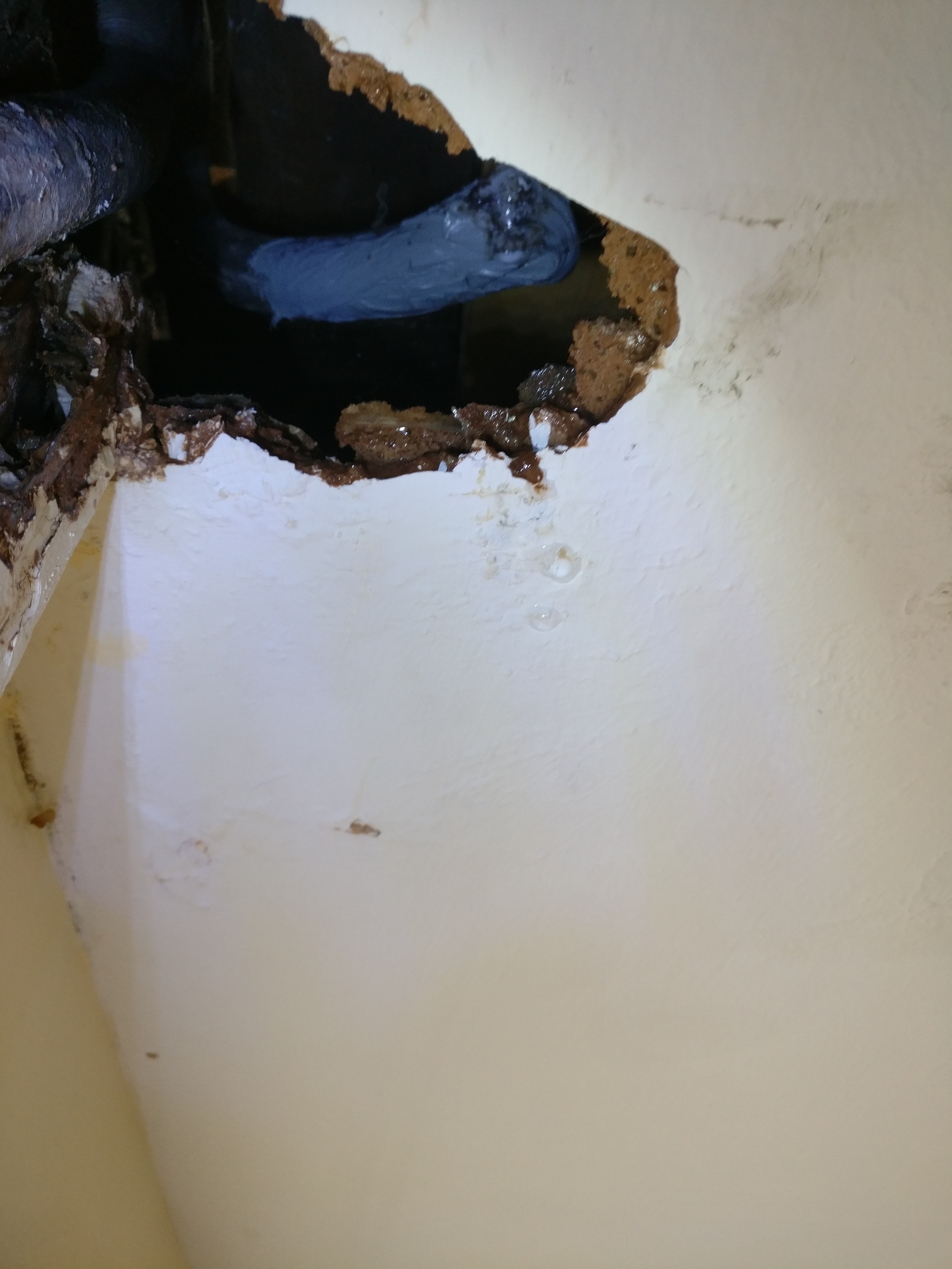

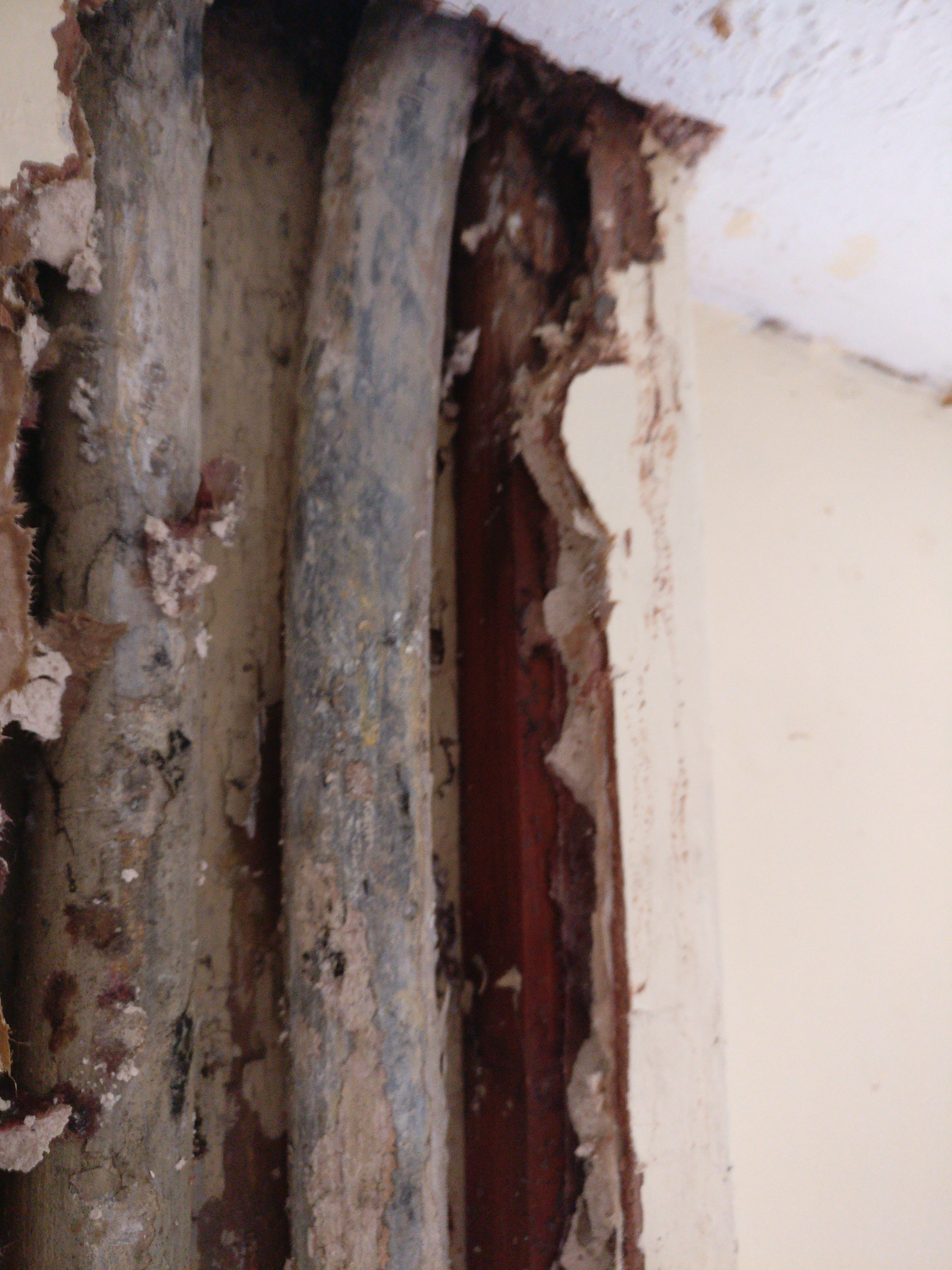

Hi, I've been trying to get a plumber to replace about 5 meters of lead pipe that has been leaking between my kitchen and bathroom.
I've had 5 plumbers round who have all said they would give me a quote later, but it seems nobody wants to do it. The only one quote I did get was for £700.
I've dug the lead pipe out of the wall and skirting, and it is ready to cut and replace, I'm going to use plastic due to the bends in skirting and ease of installation. Do I just need a compression fitting? Shall I just cut the pipe and measure it, what plastic pipe is suitable for mains cold and hot water from a combi.

2. I can't tell from the photograph what the pipe size is, but you will need an appropriate lead loc. They come in various sizes and need to match both ends.

If you are only going to do the bits shown in the photograph, be aware there is a risk that you will have to manoeuvre the lead to get the new pipe in and it may fracture in other places.

I actually found the leak last night, coming out of an end which has been siliconed or something.
