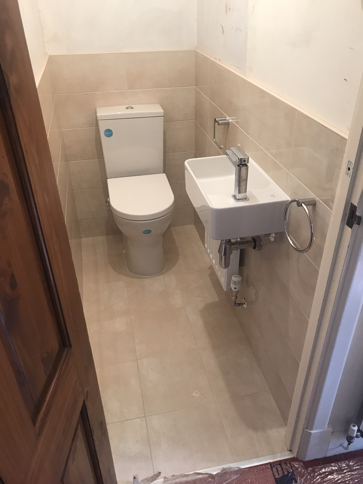

Look at vitra.
An S50 comfort height is 480mm high and therefore much easier to use for all except Persons of Restricted Growth (as Tom Sharpe called midgets).
Personally id not go anywhere near Rak as the bend is not formed as a pipe so 'stuff' gets caught up easily and flow away is severely reduced.
S50 I fitted the other week is very nice.
