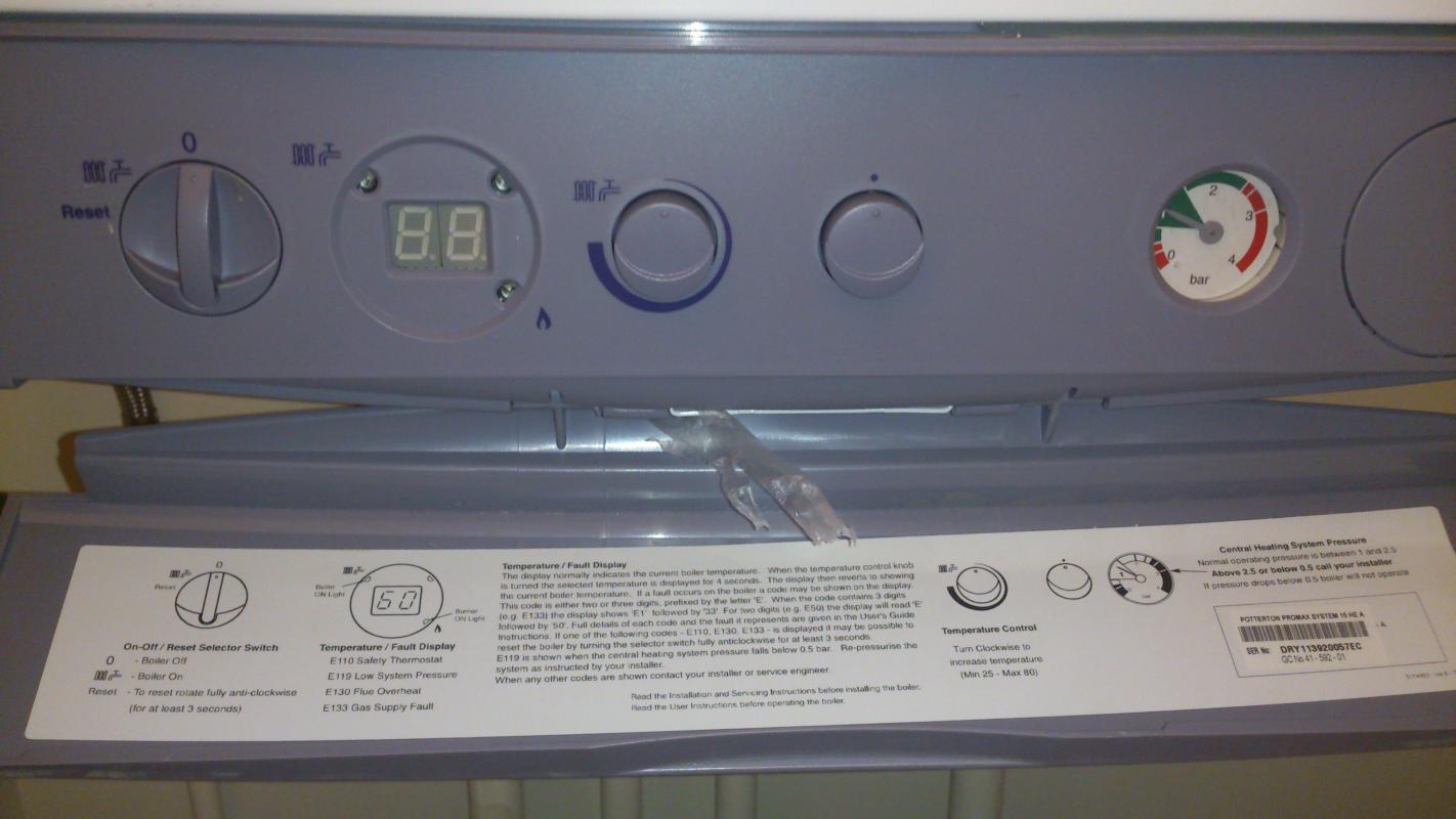

It looks like this one. There are 3 lights around the digital read out. One to show its on and heating stuff (green), one for the pilot light (amber) and I assume the top right light is for when there is an error code (I assume red).
There are a few instructions on the panel and it describes a few specific error codes where a reset will do the trick. Any other code suggests contacting an engineer. I'm not receiving any error code with this issue.

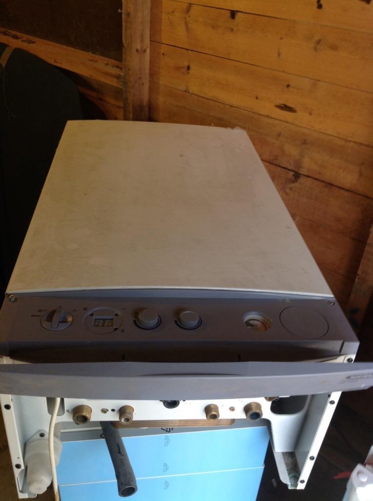

Can you not post a picture of your one?
