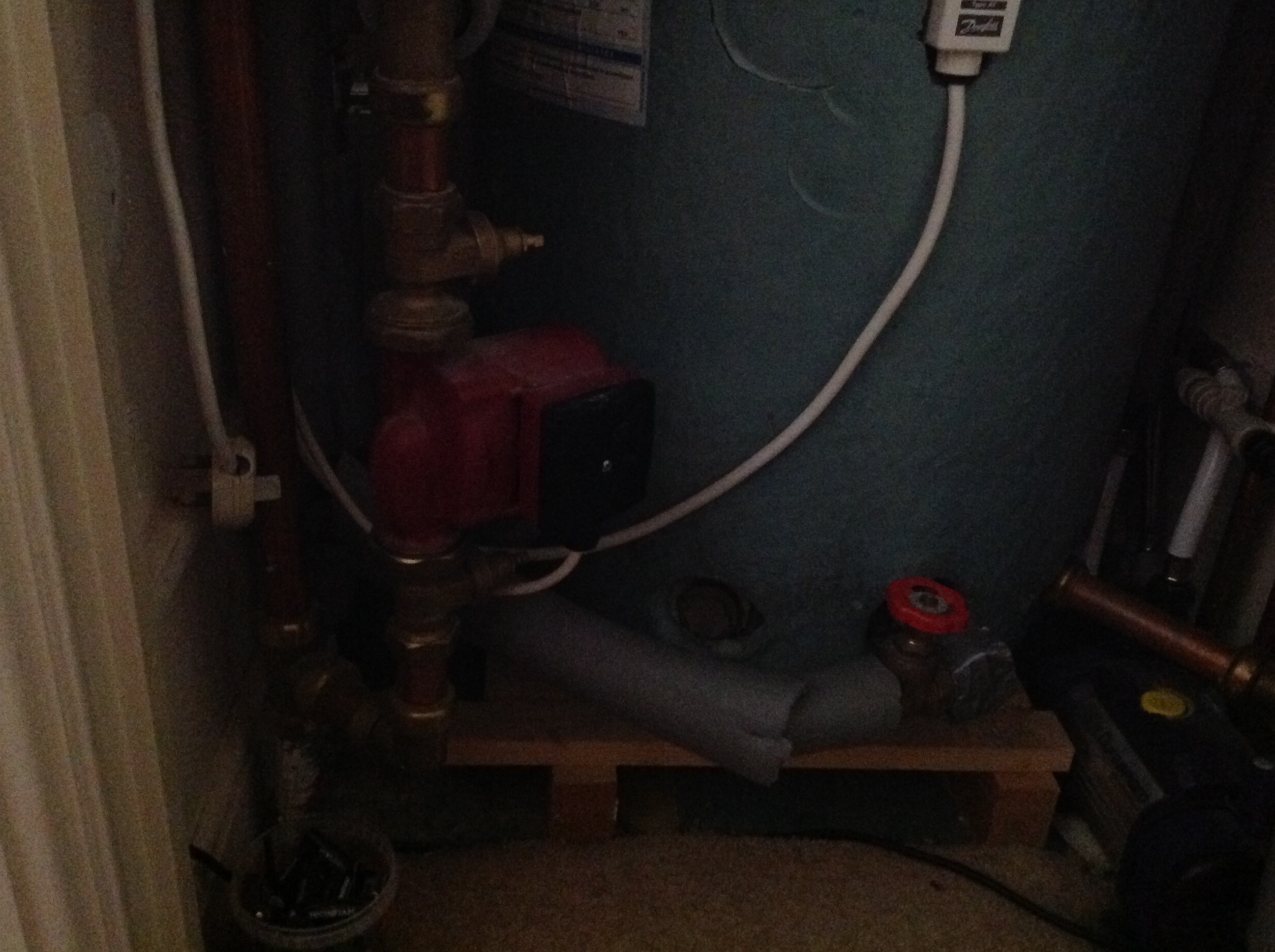

I've been away for a couple of months and when I turned my hot water on the boiler fires up but then turns off after 30 seconds or more and the status isn't showing C and the burner light flashes. Also I've noticed the pump is not making any noise in the airing cupboard although the pipe below it isn't hot. I've had no problems before and it seems only happened since the system hasnt been used for a while.
Anybody know if it's something I can fix myself?

any chance of a few pics of your pump / location?
Sorry they are a little dark
It could be a bit difficult getting to the vent screw with the pump in that position, If you Turn off the power and slacken off the 2 big nuts just a tad you can rotate the pump a bit to gain good access to the vent screw & tighten the nuts back up, then take off the center silver vent screw and manually turn the pump to free it, put the vent screw back on, (note there will be a bit of water dripping from it)! hence turn the power off while doing it. Turn the power back on and try the boiler. Providing you have 240v at the pump it should work, If it still does not run then it is time for a new pump i'm afraid.
