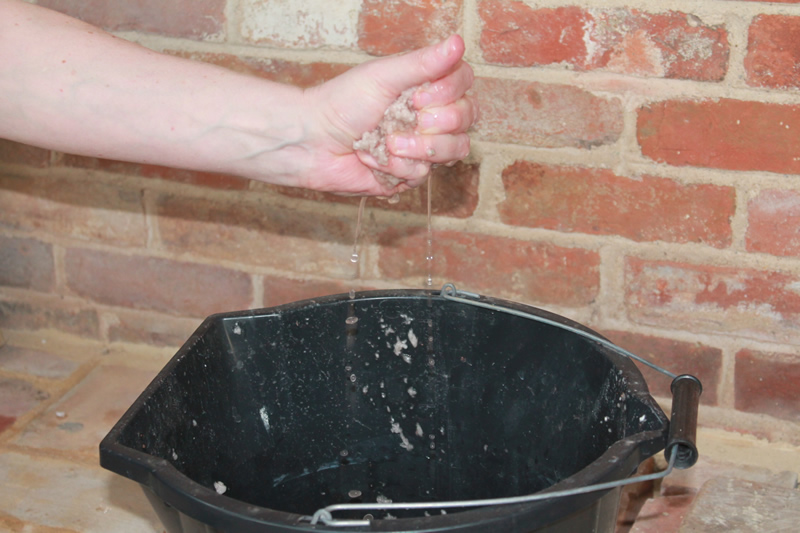

I am not a fan of retrofitted cavity-wall insulation for pretty much the same reasons that Jeff Howell gives in this article
This is particularly applicable in my region, the southwest, which has a warm and wet climate.
