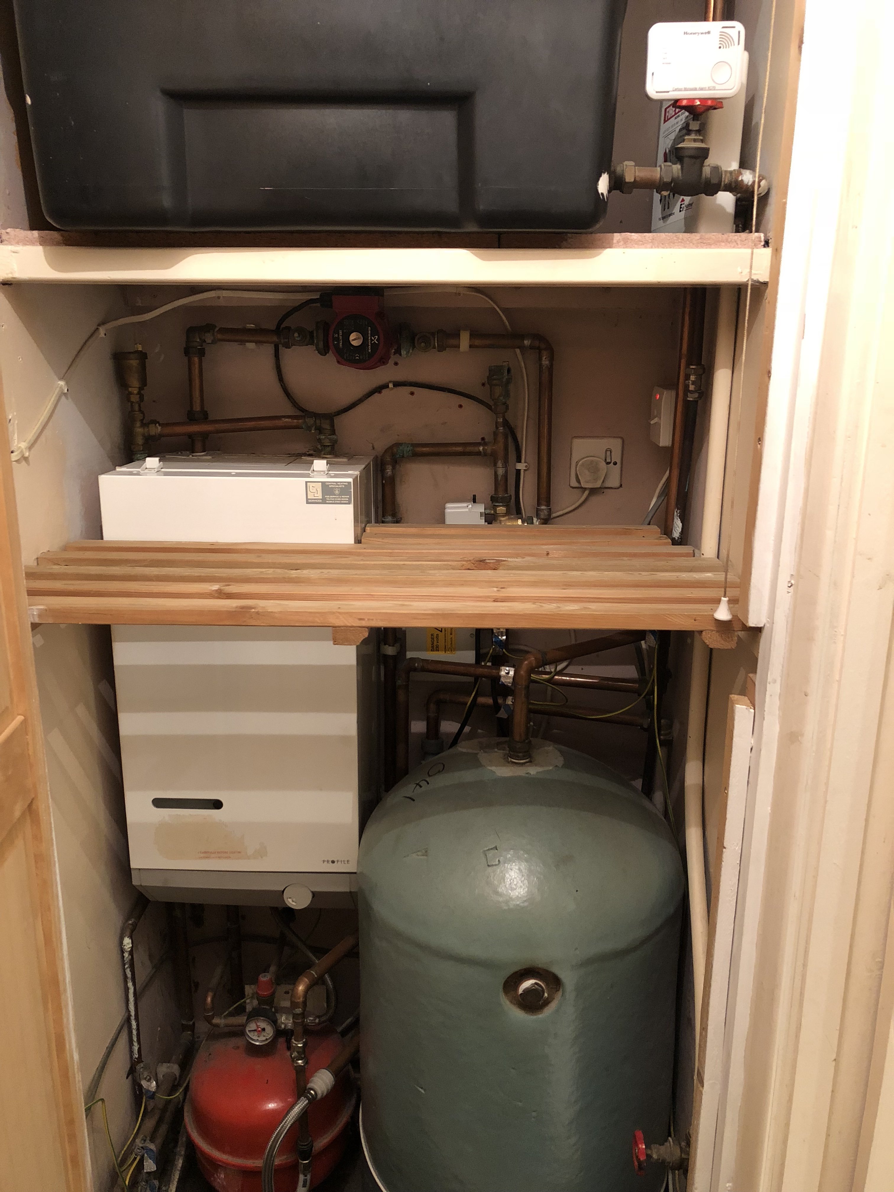

Thank you guys, been a real help. Have attached a picture of the boiler and what not. The chimney was supposedly swept just before we moved in... once again I’m skeptical.
Thanks. Chimney may have been swept but without correct ventilation you’re never gonna get the pull
