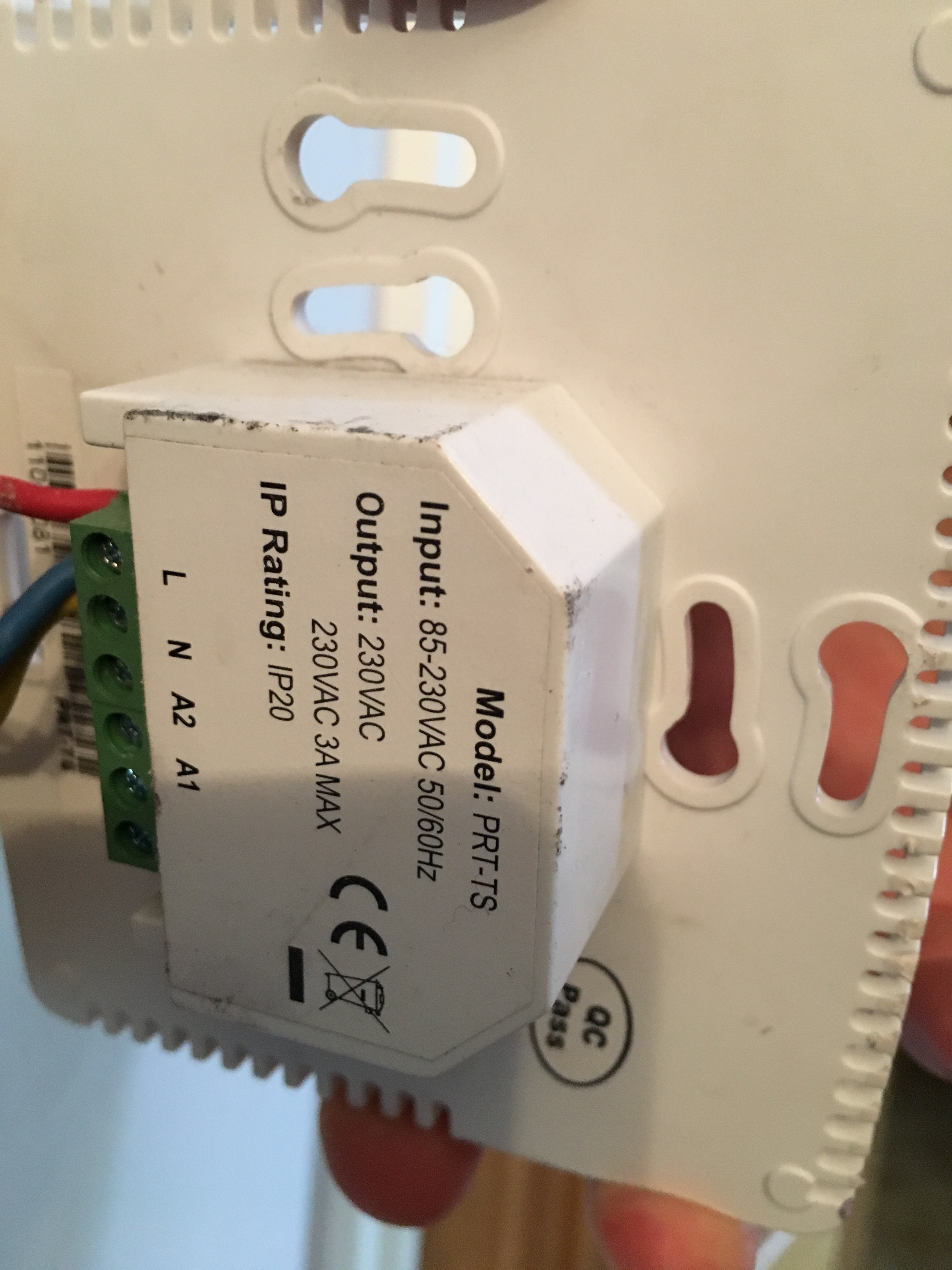

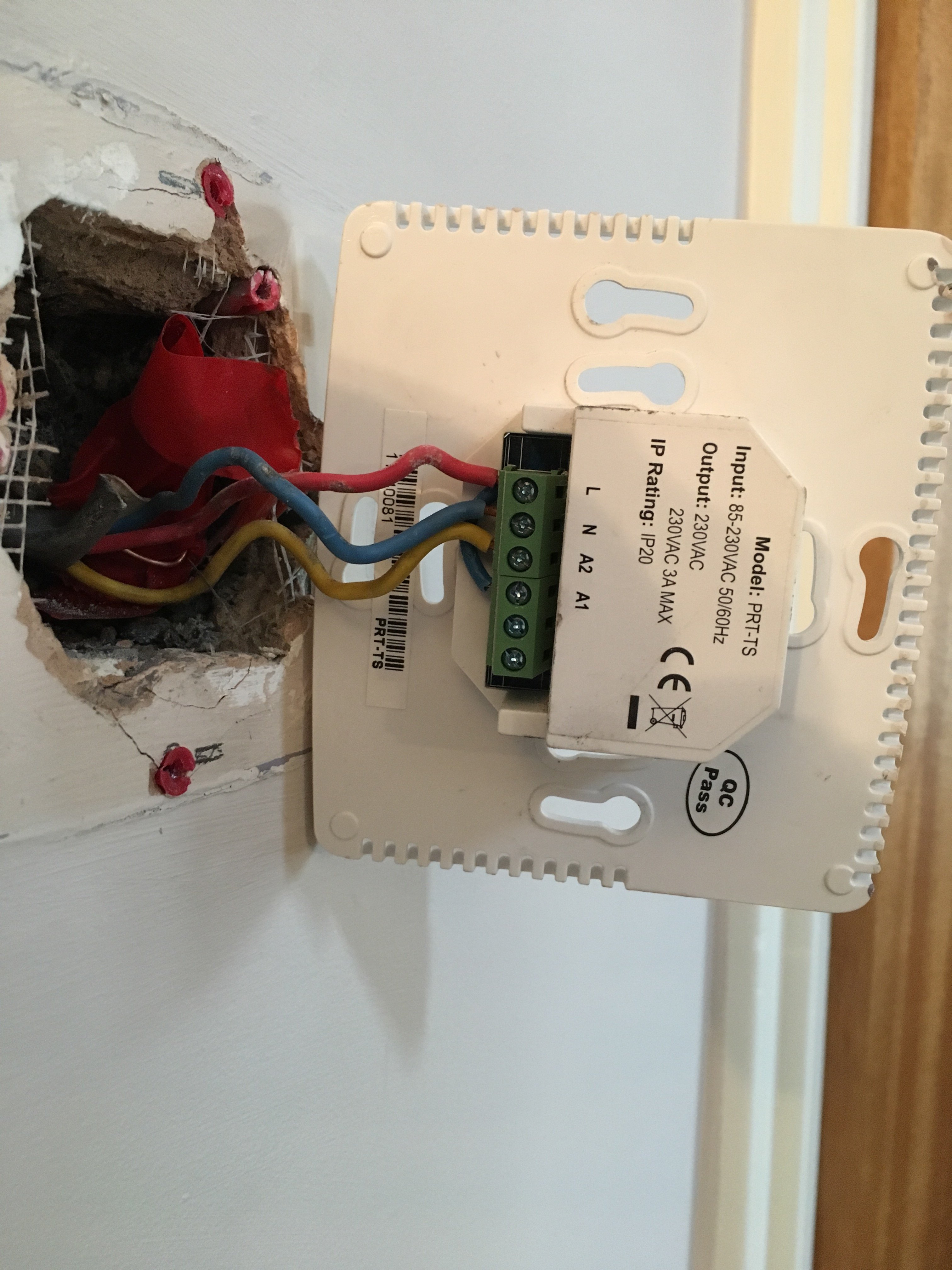

hi I’m thinking of changing my thermostat ( Heatmisertouch screen programmable) to a Nest. I currently have an old WB 28cdi RSI and will be replacing it with a Vokera 38kw Combi. Am I right to assume that all the wiring from the new or old boiler goes starlight to the heat link thing ( including power) and the only 2 wires from the heat link to the boiler are the low T1 & T2( low volt). It’s an opentherm boiler. It’s rather challenging! I’ve put a pick up of the current stat wiring.

But thanks for the pic of the thermostat. Yet another installer who has never heard of a backbox lol.

Each to his own, I could elaborate at how ept I am about using a life support machine in intensive care units and that I have a Doctrare. This site is for DIYers as well. It was a simple request for some general info LOL. However I’ll bow my head to your superior intellect in your own particular field.

He wasn’t meaning you! He was referring to the installer.

My point was that I was being sympathetic that, like myself, you've bought a house that comes with electrical installations that are clearly in breach of electrical regulations. It happens often, sadly. And often that sort of mistake is made by people who really ought to know better, i.e. tradesmen!
I can't comment on your original question because I do not have the relevant knowledge, hence saying 'no idea'.
Had I thought that you'd wired that yourself, my comment would have been to the effect that exposed cable cores outside of an enclosure are illegal and dangerous, and so, while you're about it, get a backbox to fit behind whatever you replace that thermostat with and make a real improvement.
Better still, if you are going to do DIY electrics and you do not know that cable cores need to be in a cable sheath or enclosure everywhere, then you really need to get a good textbook on the subject and read it cover to cover before you start. You just won't always get the level of instruction you need from websites. This textbook is quite a good one, I think:

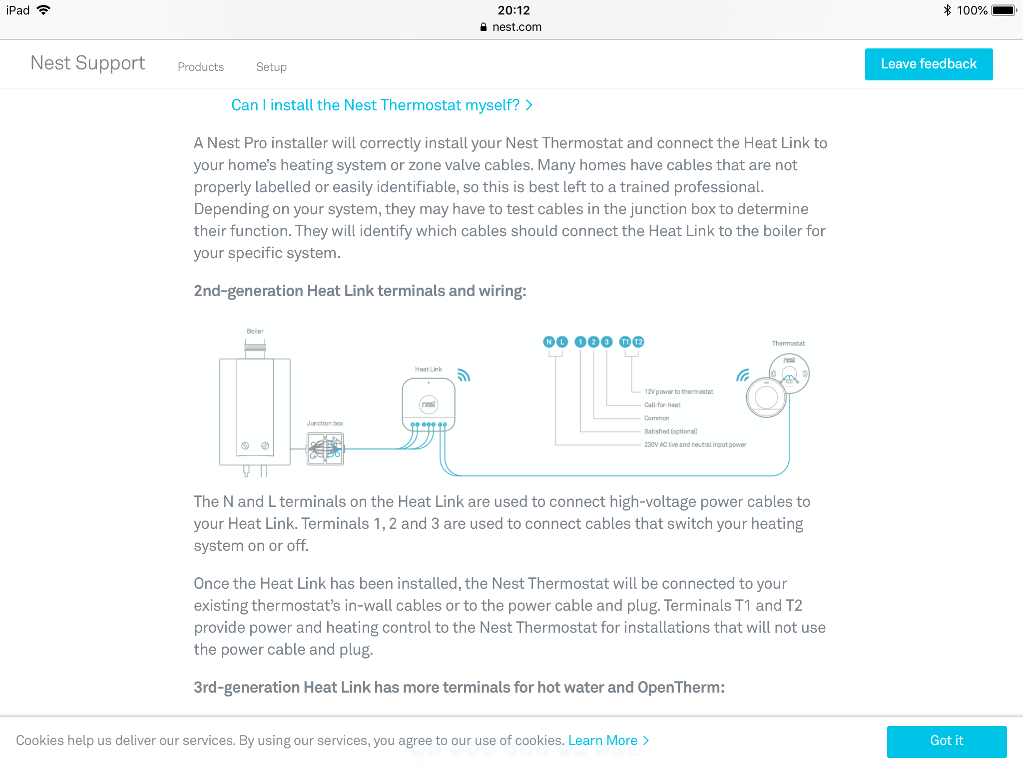

Hello David,
Im afraid you are not correct.
T1 and T2 are used to supply the thermosatat from the reciver, thermostat requires a 12v dc to operate but the switching is between stat and reciever is carried wirelessly.
For a combi boiler you woud a 2nd gen nest stat, a 3rd gen would work aswell but it is designed for boilers with cylinders.
See diagram how you would wire a combi boiler.

It does make sense to me but you have not understood my post.
You have T1 and T2 on heat link and stat now the heat link has transformer built in 240vac to 12vdc.
So you would need2 cables from heat link to stat.
Nest comes with usb charger but you need to buy a stand for it.

Yep, that made perfect sense. Ditch the old programmer and heatmeiser stat and reuse cables so your heat link will be in your cupboard sending 12v to your stat. Job done
As a foot note though. Heatmeiser also allows you to set up parameters based on outside temperature if you have a WiFi enabled stat but I’m guessing the old stat is more basic and not one of the neo range?

Thanks mate. It never occurred to me to put the heat link where the programmer was in the up stairs coluboard instead of where the boiler is in the garage. The wiring makes a little more sense now.
