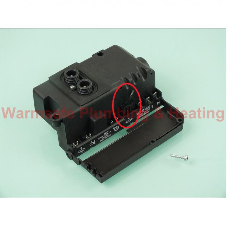

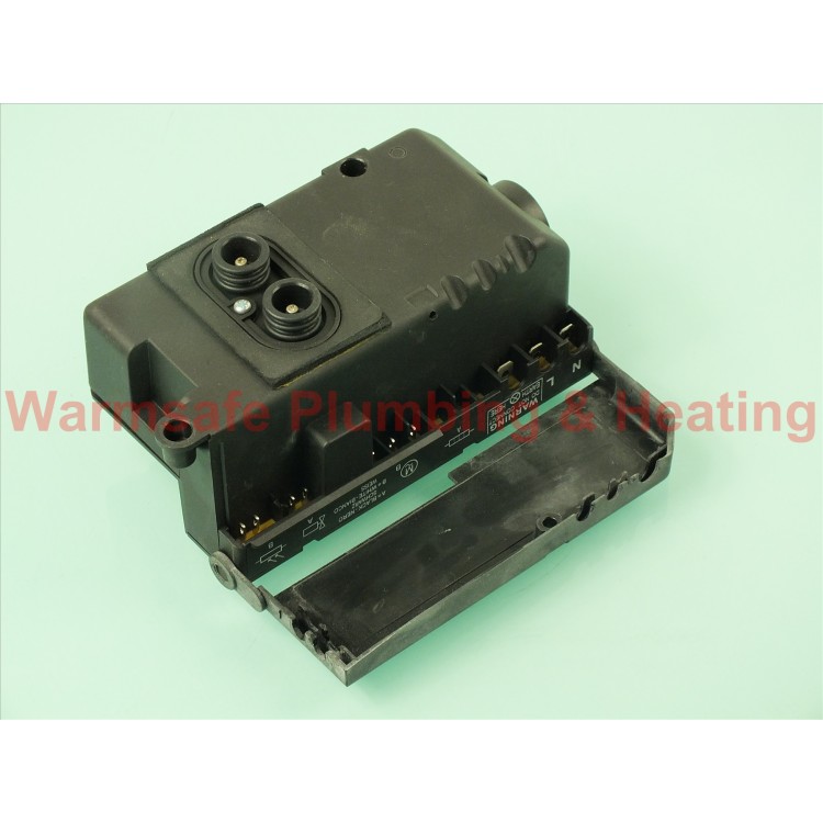

The codes are the same, however it was noted under the heating element symbol the new one had spade connectors, and that little loop connector.
However, the one we took off (the £34 one on warmsafe), does not have this little loop thing.
Is there a difference between these two control boxes? Will removing this little connector make it work or are they two completely different boxes?

The only difference is that one is a digital control box. Allows for remote reset of lockout. I.E. Worcesters.
It's not the solenoid or the control box. Did either engineer check the combustion?
Which one is the digital one?
Attached is the loop thing i'm talking about being different (On the £49 control box)
Everything else is identical between the two.
