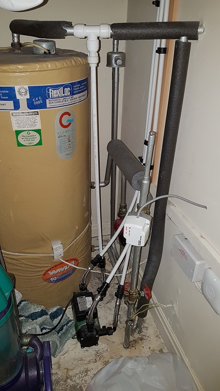

My wife was having a shower, the kids were in the bath and decided to run the tap and I think the washing machine and dishwasher were both on.
The shower pump (salamander CT50+ twin) suddenly stopped working. Now it only works on hot. If I turn the shower temp to cold, it turns off.
I have switched it off at the mains and turned the shower on to try and remove any air. If it’s set to hot water comes through but hardly any comes out when on cold.

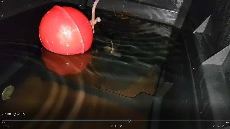

I phoned the manufacturer and a chap asked me to check the cold-water tank in the loft for any blockage. This is where it gets confusing for me.

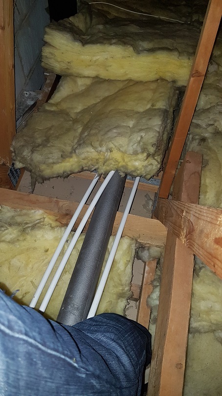

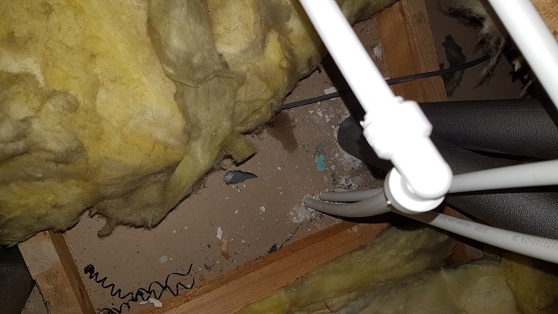

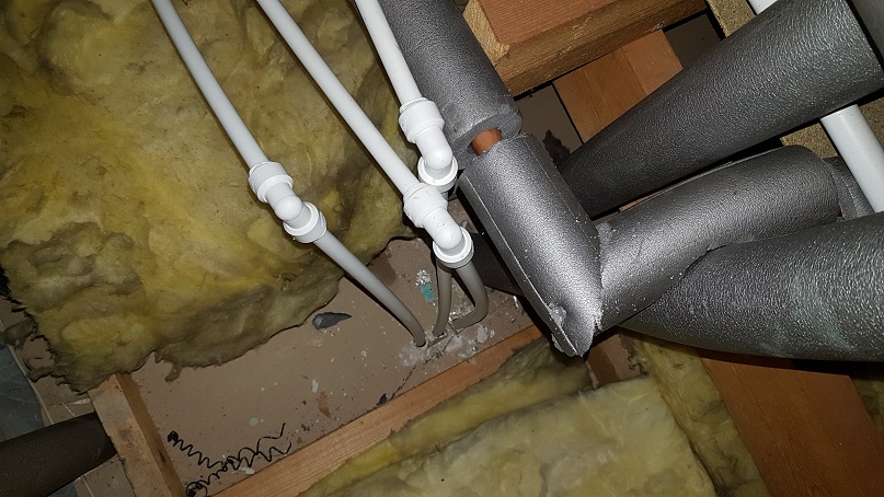

There are four pipes to the pump. I’m assuming this hot and cold in and hot and cold out. One pipe comes from my hot water cylinder and another leaves on the same side up into the attic, so that sorts that one out I think. Of the remaining two that go up to the attic I thought one would connect to the cold-water tank, however all three pipes go up into the attic and then towards the shower. None seem to connect to the tank. I also notice as I moved them sideways to have a look there a was a slight hissing sound at the 90 deg bend of the left one. Could this be letting air in?

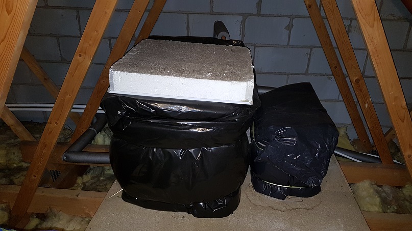

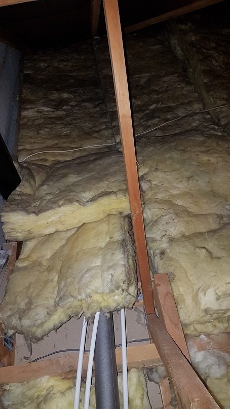

On top of this there are two tanks, a larger and a smaller one. I had a look inside and they don’t seem too clean, the small one is particularly bad. Could they do with flushing and cleaning? What is the smaller one for, I'm assuming CH expansion tank? It looks quite empty.

Install isn't the greatest sounds like something's gone in the pump the big one supplies your pump little one is for your heating

Can I just check, with the pump horizontal and the lower inlets at the back, I would have though right side would be hot in and out as the the pipe to the inlet comes from the hot water cistern? See picture. Has it been connected up wrong, or does it not matter which way round it goes?

The shower works but I decided to look at the hissing pipe. It has a slight drip from it. I have tracked it as the cold-water inlet pipe. It doesn’t come from the tank as all 3 pipes track into the loft.
I fiddled with the joint to try and tighten it, but does anyone know how to tighten it properly. I don’t know how to isolate it so don’t want to botch it.
