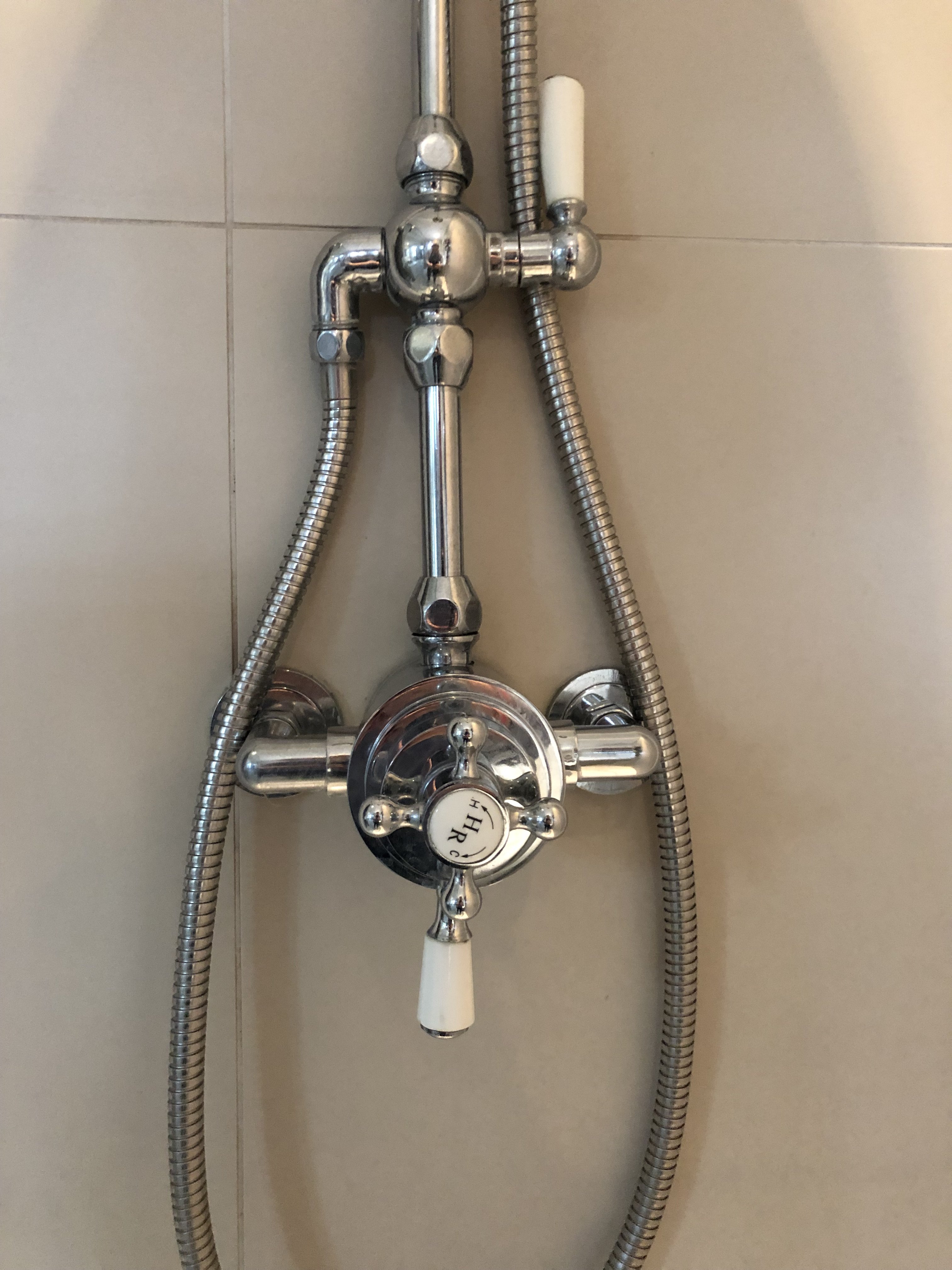

I don't know the make and model as I bought the place a couple of years ago and no branding on it but maybe Hudson Reed. Here is a picture at any rate
Hello, It looks like a hudson Reed shower valve (maybe topaz)
As said before it sounds like an internal issue, maybe debris in the filters &/or cartridge. Usually a build up of limescale, if you can take isolate the shower valve, remove the cartridge then let the cartridge soak in white vinegar for an hr or so then try it back in.
