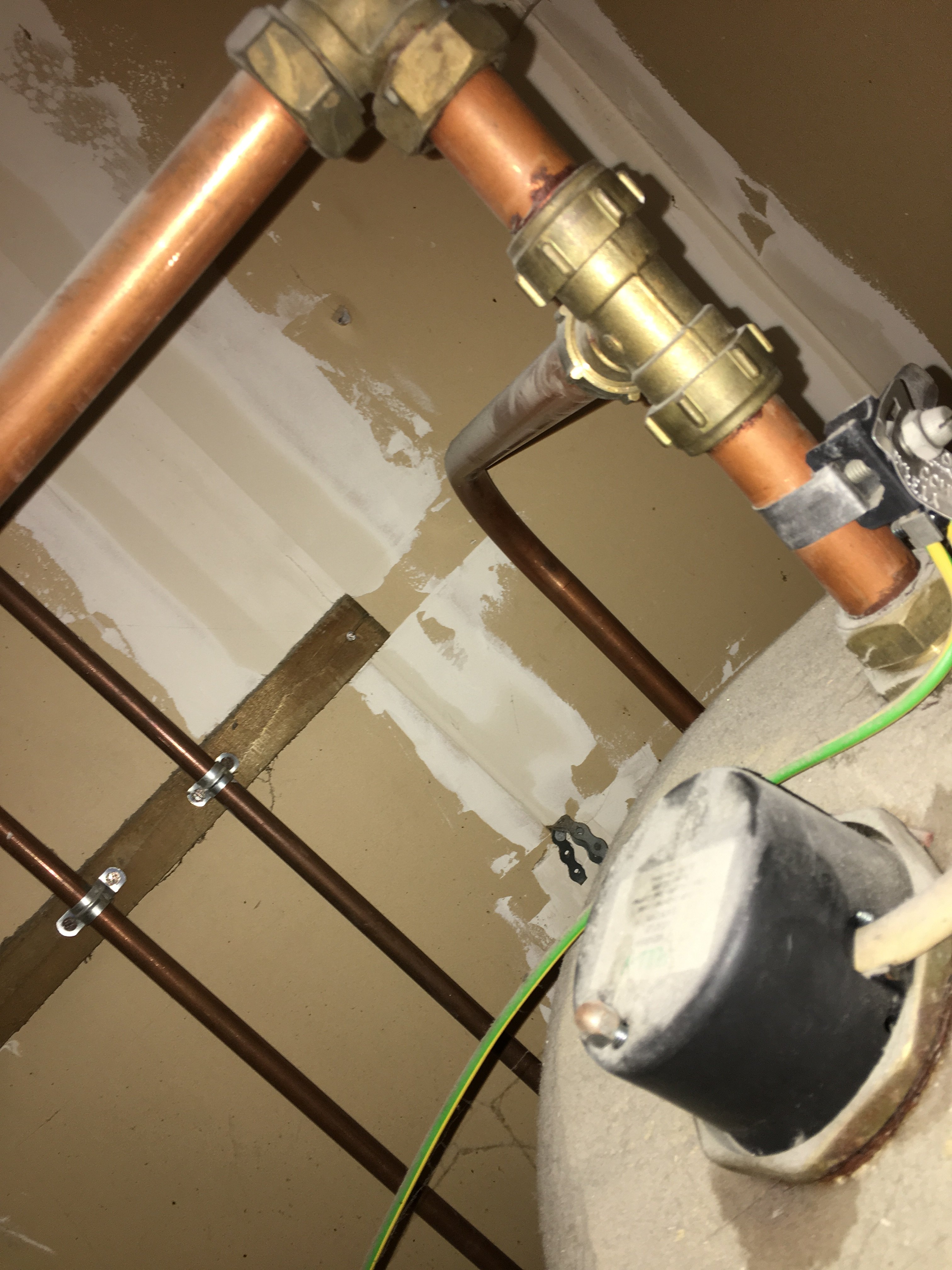

  5. Stewartjohnmuir
    Stewartjohnmuir New Member
    I have attached some pictures of tank , not sure what to snap
  6. Chuck
    Chuck Active Member
    From what I can see on the photos, the shower uses a high power heater to heat cold water at the point of use. I think you almost certainly have some wiring overheating, which is a potential fire hazard.
    KoP was spot-on as usual, don't use the shower until a qualified electrician has checked and fixed the wiring.

  7. Stewartjohnmuir
    Ok I will get on it. ASAP. I just find it weird how the smell is coming from the cupboard where the tank is and not in the shower part at all. If I have the coal fire on and the water is hot then the smell doesn't appear ???
