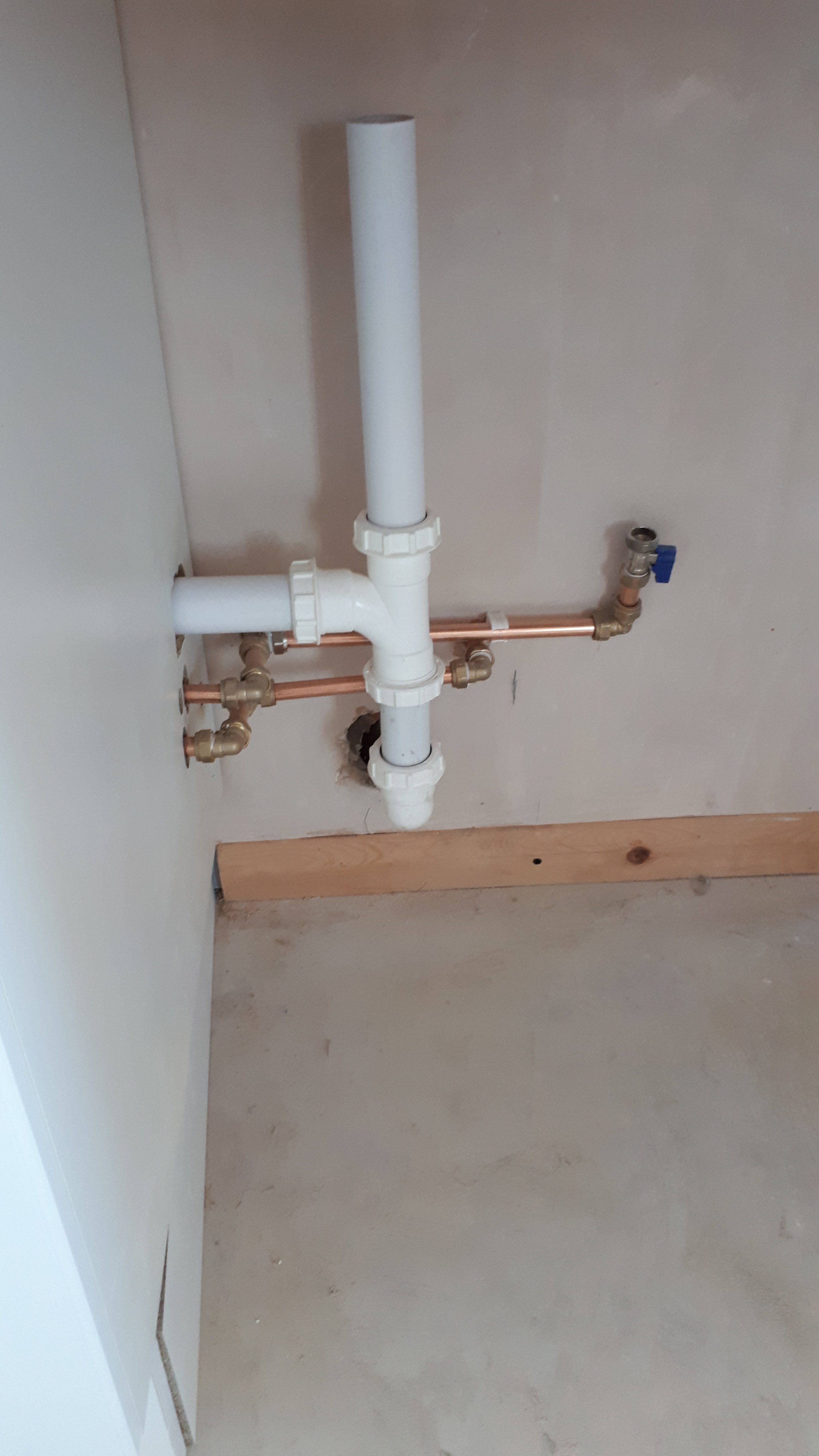

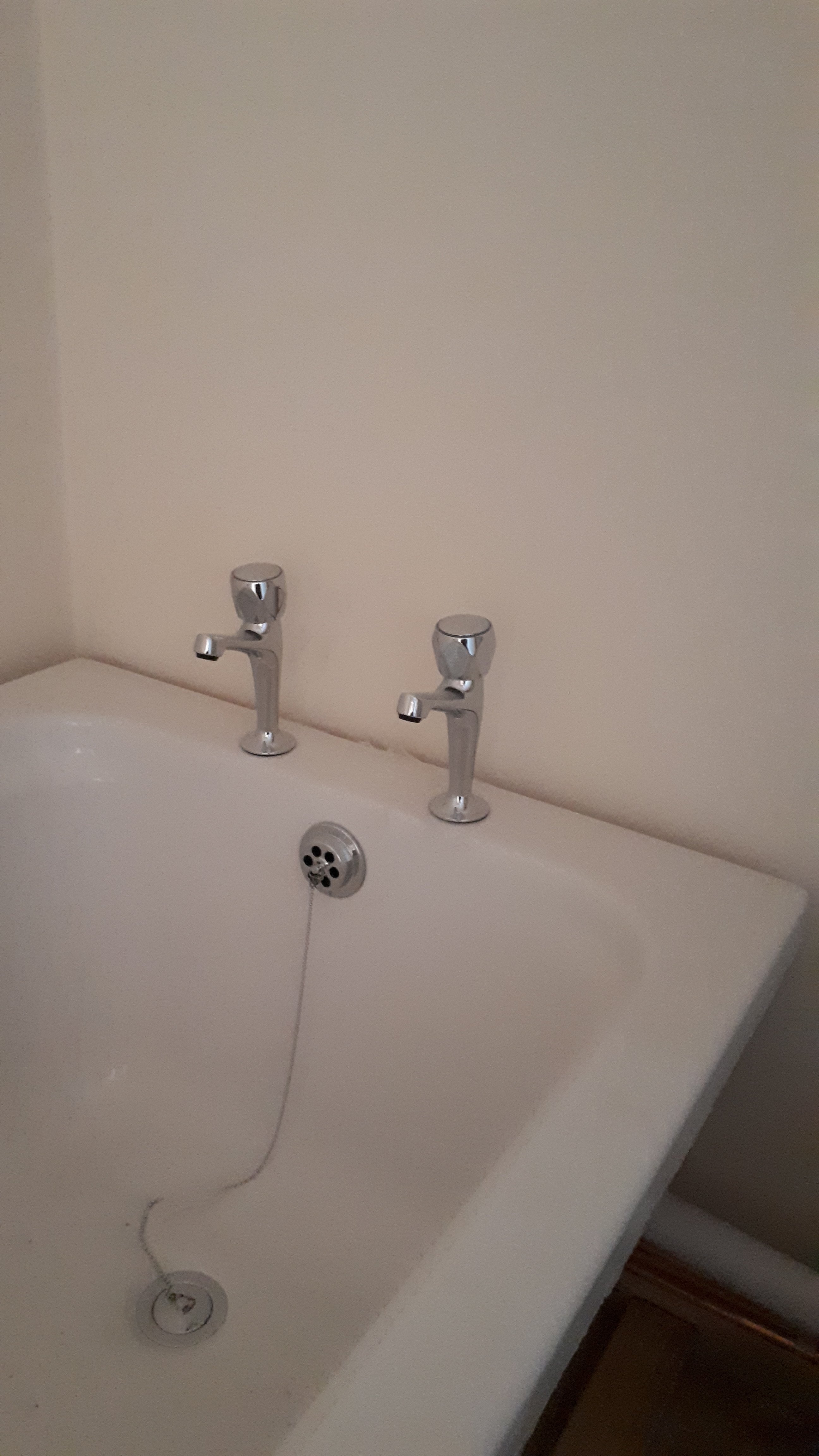

Have a landlord and appliance shop owner who I fit cookers and hobs etc for who's currently turning old shops into a couple of flats. I've put in the cylinder and tanks and new cold water mains but was not asked to fit the bathrooms which I couldn't understand. He wanted the so called builder to do it and for me to commission it only because he's paying him peanuts for the building work so getting the bathroom installation cheap. So I dropped in to check it and I compare it to going into an exam room to spot all the faults which I lost count of. Kitchen taps on the bath and basin,bath won't go in the corner due to the waste pipe against the legs,bath trap elbowed up to the waste pipe leaving 6 inches of water in the bath,all compresion fittings with tape around the threads lol and from the 22mm I left from the hot water draw off reduced down to 15mm again on a compression fitting.ended up taking it all out and starting again.
Probably, bar any dangerous work, overall the worst work I have seen posted on here!
I wouldn’t trust one little part of any of the work done there.
Clearly a complete plumbing novice to have done that!
Silly to have allowed anyone to have taken that work on, even if they had been free.

On the contrary I didn't take much removing as nothing was secured in place no surprise there. All put back in place now with the conversation to the owner of I told you so being very satisfying

There's no point wrapping it around the threads if it's needed at all wrap it around the olives took me ages to take it all off from this job
Interesting. When I was shown the basics decades ago, it included putting tape around the male thread as a cleaner way than using jointing compound. Are you saying use nothing at all unless you get a leak?
Around a Male thread yes. Around the thread on a compression doesnt do anything. The olive causes the seal a bit of paste around the pipe/ olive is enough
Speaking as a home DIYer / novice myself, whilst I can see what's wrong in all these photos can someone enlighten me why the use of PTFE is wrong? I've used it on several joints at home and feel a bit embarrassed now :oops:
The threads on a male joint are solely where the water can pass and need ptfe or other to seal.
The threads on compression joints are not solely where water can pass and are only for the nuts to hold the fitting together between the compressed olives.
If the olives failed to seal properly in a compression joint that you had also used ptfe on threads, then the water would just pass between the gap between nut and pipe
