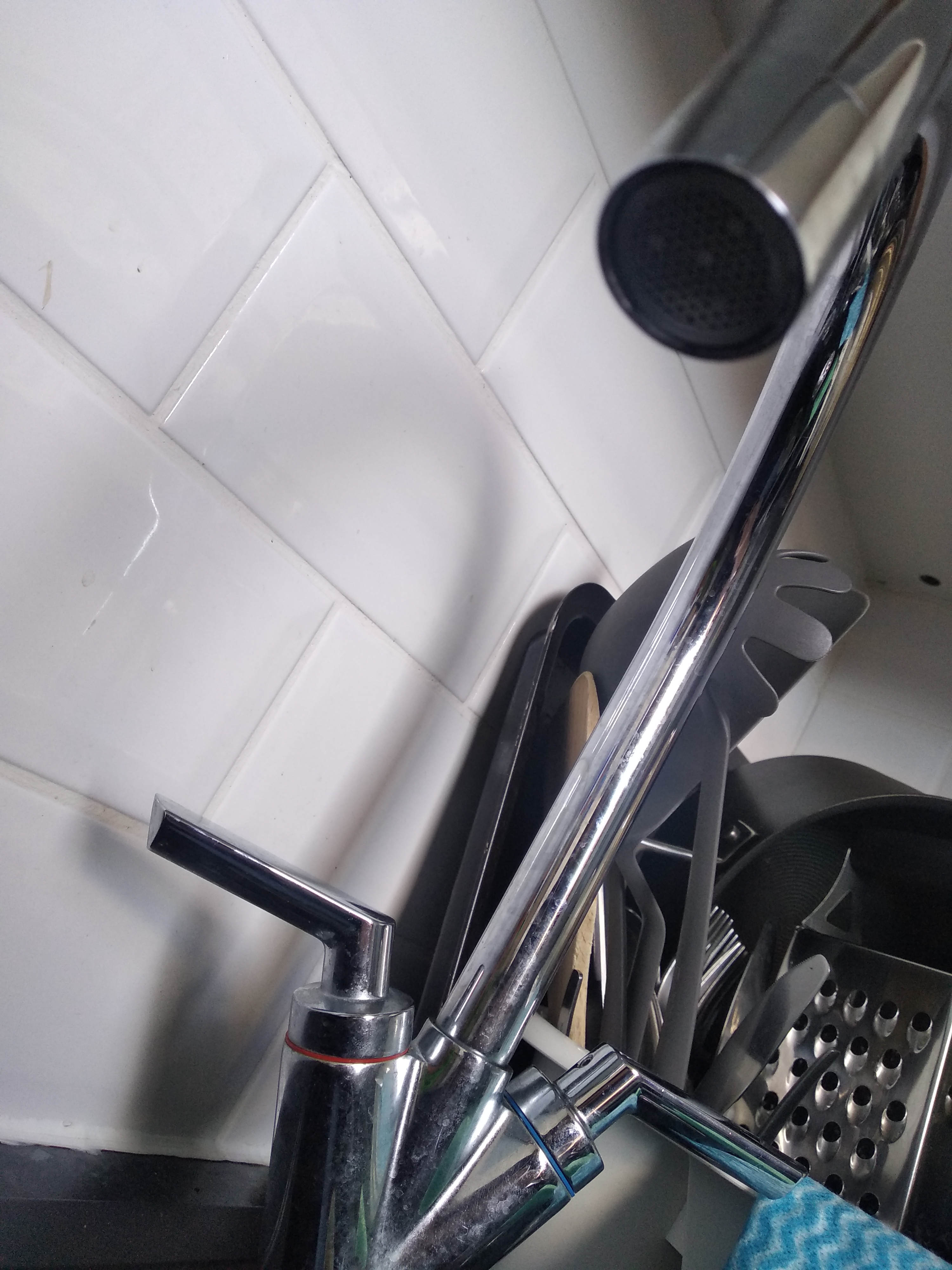

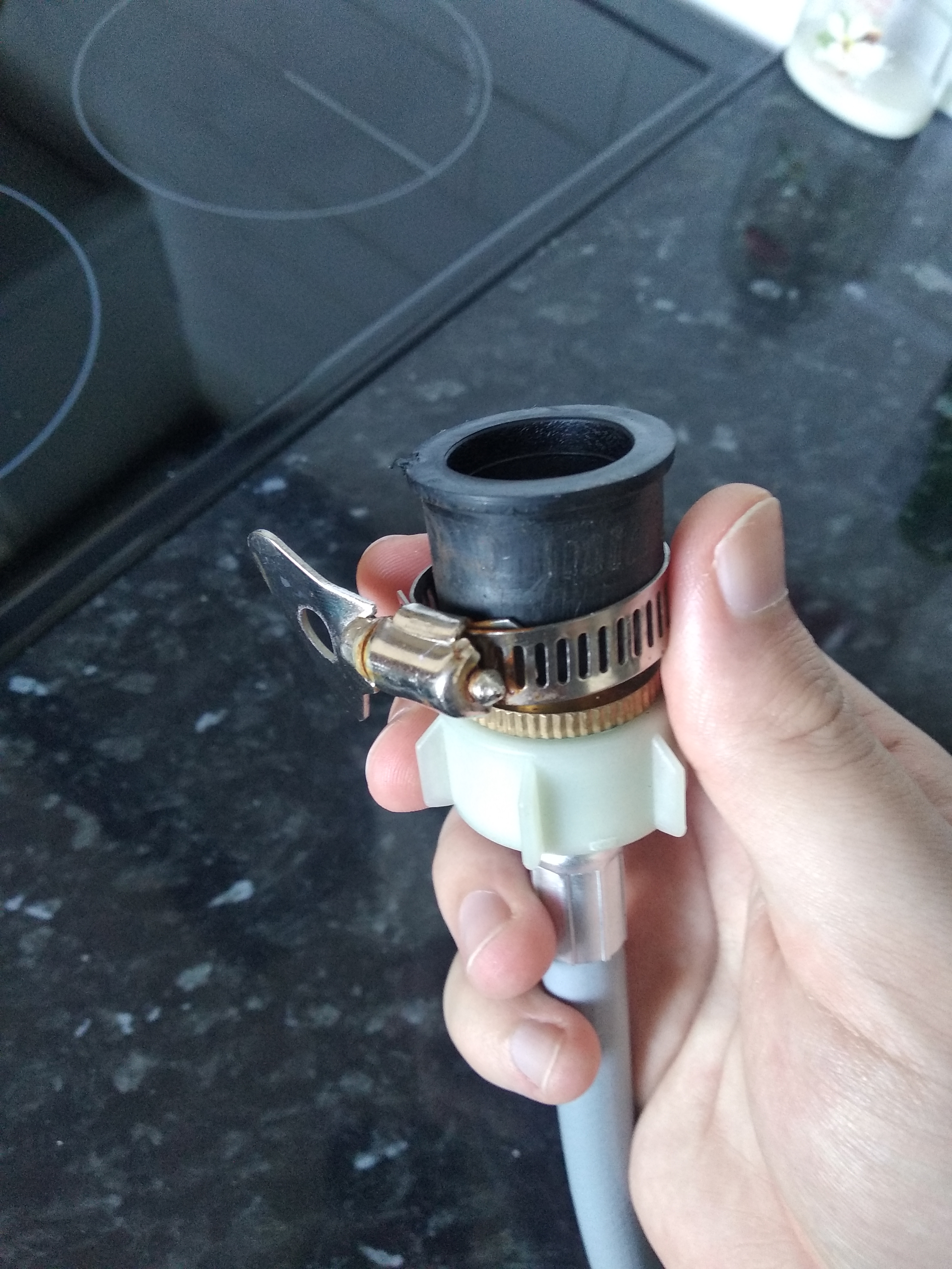

I also got an attachment to fit it to her kitchen tap. It's definitely the right size. This is what the attachment looks like and what the tap looks like.
I attach it to the tap, switch the dishwasher on, start a run, wait until it engages, then turn on the tap.
We can hear water flowing into the dishwasher and it begins washing the dishes. After approximately 10 minutes it stops taking in water and pressure quickly builds up and the attachment pops off of the tap.

Because the wing nut band can’t grip tight enough for the amount of pressure when the fill is finished. You may need another way of attacking to the tap
I don't think you are doing anything wrong.
The water pressure is high enough to cause the adaptor to slide off the polished tap spout.
Are you making sure the metal band that you tighten is positioned at the top of the rubber part before you tighten it up? Also of course the tighter you can make it, the more pressure it will withstand before popping off!
Otherwise, if you can unscrew the aerator at the tip of the tap, you might find a screw on adaptor to fit, like this sort of thing: Indoor Threaded Tap Connector | Hozelock Ltd - https://www.hozelock.com/product/indoor-threaded-tap-connector/
Thanks for the help guys. Unfortunately, we have been fastening it as tightly as we can, as high up as we can.
I will have a go at unscrewing the aerator and directly attach the pipe! I hope this works.
