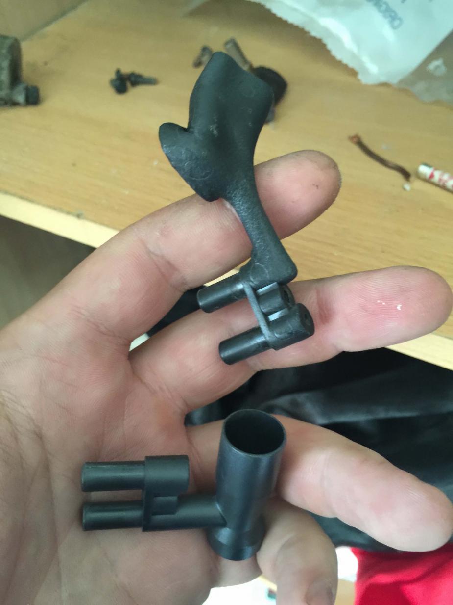

Hey guys went to a baxi 105 with flue fault & I thought it was a aps fault as it fired when I blew into the + on the aps but new one was the same.
How do you guys test the Venturi without taking all the fan out?
I attached my digital manometer to the + symbol off the fan & got a really low reading, something around 0.6 mbar!? I have since read the Venturis can melt on these?
