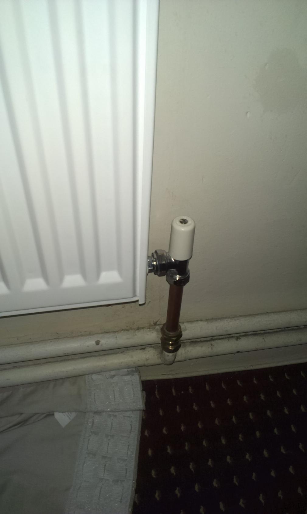

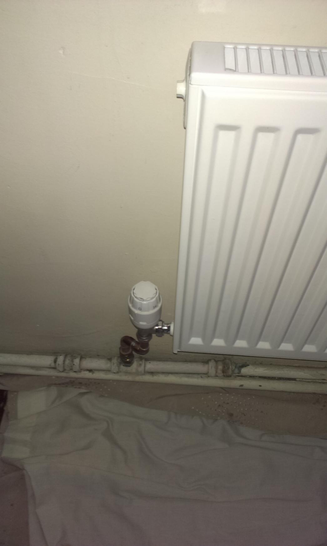

Rather than get stressed why not let your mate swap the stat to the other side see if that resolves it ... If you need it to be thermostatic you can get a TRV with remote sensor that fits away from the radiator.
Like the above post.
Forget how hot the radiator is. Is the room up to about 23 to 25 degrees. If it is the trv is doing its job.
Looking at the pictures it could just be the heat rising from the pipes below causing the trv to shut. Try wrapping an old blanket around the pipes to insulate them and see if it makes a difference.
If it does then you are looking at fitting a TRV with a remote sensor or insulating and boxing the pipes.
