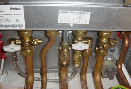

So, had Vaillant called out to service the boiler, could find nothing wrong with it, they also pumped up whatever it is that has a schrader valve on it? Expansion tank?
I mentioned that I was having to keep bleeding the radiator and the reply was that it was possibly the expansion tank or if not that it was a small flexible pipe underneath that may have a seal gone? I would of thought this would have figured in the service or at least when put on notice it would have been checked.
Well I'm still having to take water out of the system, every 3 days i drain it down to 1bar on the digital display (not the small window with a meter as that seems more of an indicator than anything accurate, by the third day the pressure (when the heating is off and cold for a few hours) is back up to around 2.8 (by the digital display)
The small flexible hose, am i right to assume that
A: This is a Vaillant only part and cannot be sourced from any good plumbing centre and that
B: That it can only be fitted by a qualified (gas safe/corgi) engineer?
I want to take out a service plan on the boiler but feel that until this issue is fixed that I cant and I'm away in the
next few days and don't want to leave it the wife to remove water from the system.
Bloomin nuisance that it wasn't sorted at service even though I'd flagged it.
