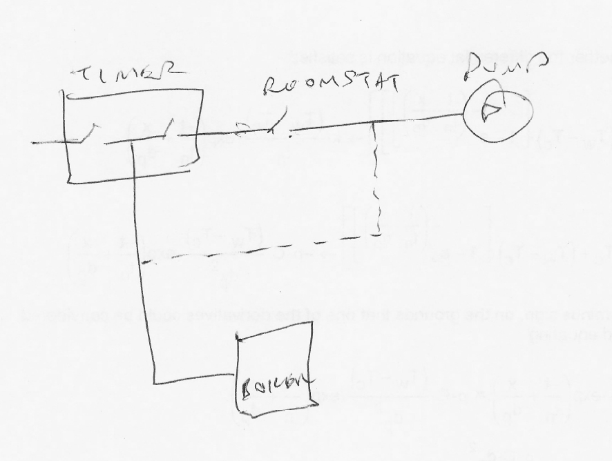

With gravity HW, you can only have HW only, or HW + CH, not CH only. Wiring diagram below (I forgot to label the switches in the timer, but it's self-explanatory).
But what you could do is rewire it as the dotted line. Then the boiler only fires when the pump is running, ie only in CH mode. That would get rid of the kettling. You would need to use the immersion for hot water, but you've been doing that anyway.

Agreed, you would have to use the immersion for hot water. I assume there is no cylinder stat, or any automatic valves (in the cylinder circuit)?
As it is, any time the whole system is available on the timer, if the room-stat is satisfied the pump doesn't run, so kettling will happen. The revised wiring avoids that.
To add to that - if you do this mod I would also close a valve in the gravity circuit, otherwise you could get some flow through the cylinder from the pump, cooling it before things get up to temperature. So you'd be partly heating the house with electric, which you don't want.
