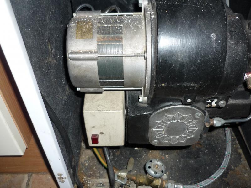

not sure before my time. Could not see any names it is Orange.. looks same as this pic

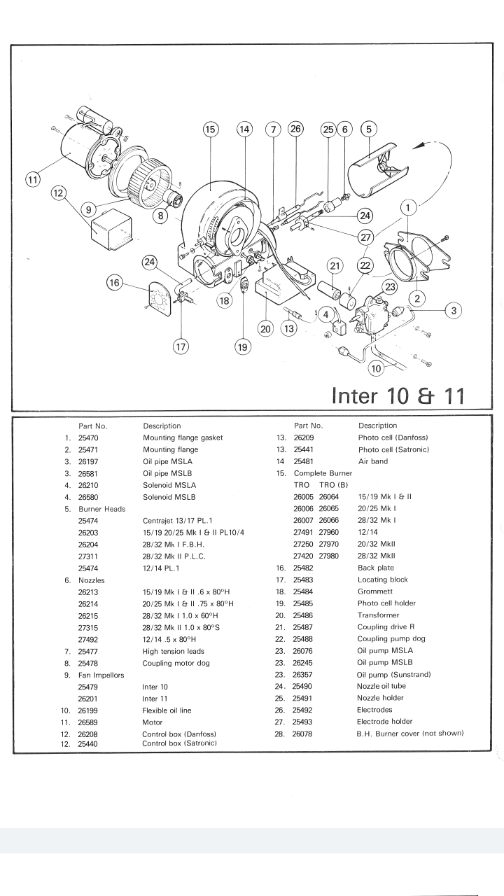

That's out of the instalation manual . I tried to upload but it's through GIW ( gas installers workmate) an app I use for boiler manuals but it won't let me . Hope the pic helps
Just suddenly realised you said burner is orange in colour!
The air “door” on the orange burners is a round piece of metal band that is adjustable by a bolt and is a stupid idea because it can block with dust where it gradually tightens.

Just stumbled across this . Looks like my troublesome burner. Cant see a diffuser washer behind nozzle on it or am i mistaken. Is this the same burner for myson valarie ..?
There is no separate air diffuser on that burner.
It is a one piece blast tube and that tends to make it much better and not complicated
Best is right, no separate diffuser. I have managed to reassemble the burner with the nozzle not in the correct central position! Ie not in the circular holder, if you see what I mean?

The plastic bit, no 17, locating block... No not replaced this. What is it for? I did not access through bank plate.
No 17 part is to hold the nozzle assembly centre at the front of burner (to keep the nozzle at other end straight) and no 17 also adjusts the nozzle distance to front of diffuser. (It has a bolt threaded through it to pull nozzle out and in.
Do not adjust it!
