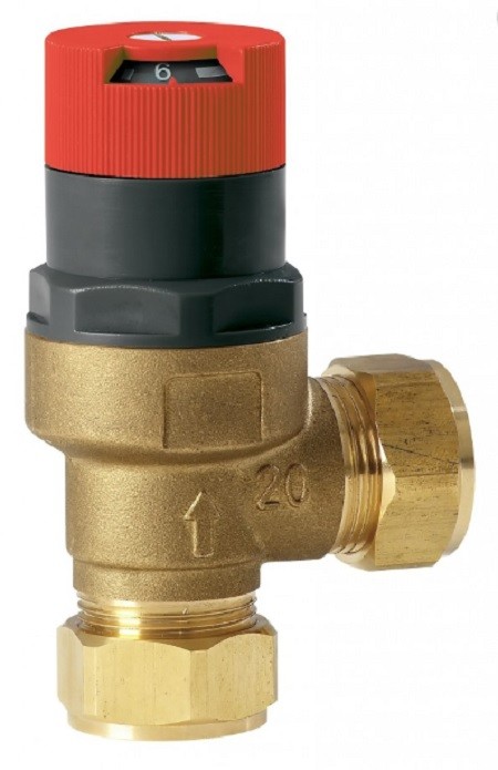

That boiler may be a heat only boiler with a external circ pump, this might be installed in your hot press or close to the boiler, you may also have a mid position 3 port valve or a number of two port (motorised) zone valves, if you have the mid position valve, no need for the ABV, if a number of two port valves, the ABV, if installed, will be close to and between the pump and these two port valves.
Below, you have a ABV, a two port valve & a three port mid position valve.
The pump is running at max setting, CC3 which is > 6M so the setting on the ABV, 0.4?, 4M, should be quite adequate to to allow the ABV to open when the boiler/burner trips on shutting the HW and CH zone valves, the pump then, if wired correctly should run on (overrun) for ~ 3 minutes to cool down the boiler heat exchanger.
Can you feel the pipes on either side of the ABV with boiler running, are both sides hot?, then switch off CH & HW and see if the pump runs on for a few minutes and check if (ABV) pipes are now hot (if not previously).
How many rads have you got?.
