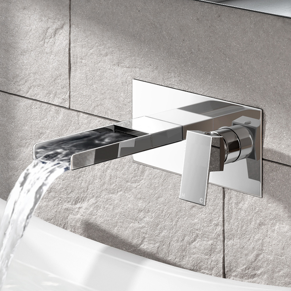

Hi, I am about to buy a wall mounted water fall basin tap, and a builder warned me to be careful as a lot of them are "very low quality" and he's had to replace quite a few. Not sure how correct he is, but I shopped around and saw many different sellers on amazon, ebay and various online shops selling a tap/mixer that look identical but at different prices (from £40 to over £100), different brands (Vellano Reve, Zenith Dunk, Desire etc) and different lengths of guarantee (5 years, Life guarantee, 10 years).
Do they vary in quality or are they all just rebranded versions of the same tap? Here are two of many "versions":

Here's a photo:
As you can see from the links (and there are loads more), there are different sellers selling what looks like the same tap under different brand names with different prices. Just wondering if they differ in quality/finish as the photos look pretty much the same...
