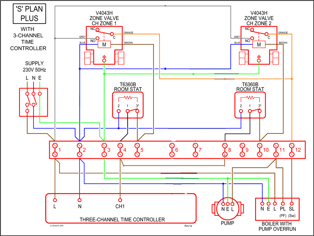

Does anyone please have any links for a wiring diagram for a new housing association home.
It has a Baxi condensing boiler, 2 Zone valves and 2 separate Mysson MPRT programmable room thermostats.
I'm assuming this is now a requirement to have upstairs and downstairs on separate zones.
Many thanks, Alan
Just wire in s plan or s plan + if not combi
Exactly the same as normal s plan wiring.
Thanks for your replies guys.
I had checked the S Plan but the system I have to wire has no tank stat or individual programmer.
The boiler is a Potterton Promax combi with 2 separate Mysson Power extra zone valves each operated by 2 separate Mysson MPRT programmable room thermostats.
Any help appreciated.

what boiler? and are the already installed as you could be wired a few ways
think as channel 1 the live out (from the boiler ) and think of switch live as call for heat (live back to boiler)

You just wire it like you would a normal boiler. The programmable stats switch the valve, so no need to wire in a timer. Switch live from each stat to power each individual valve.

This diagram should help if you also have a cylinder, if not there's a few example diagrams on the same menu click here
