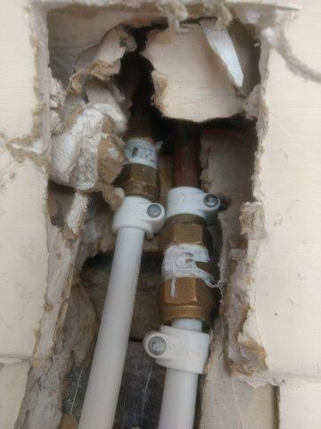

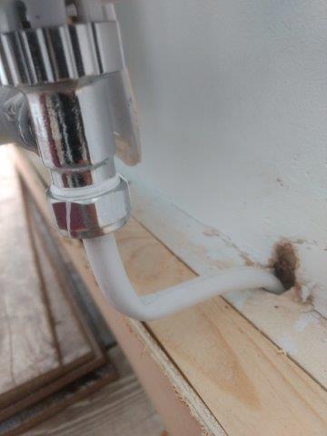

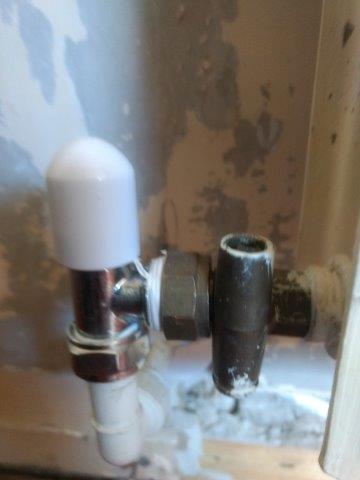

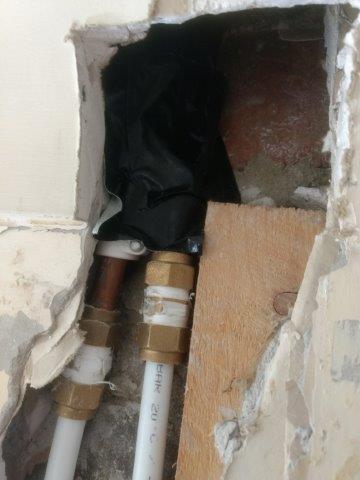

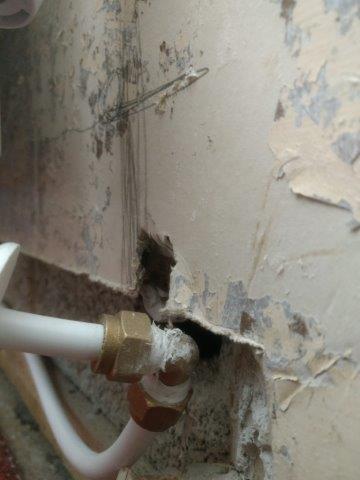

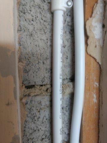

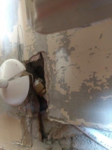

    Hi I am new on here, this thread is similar and i couldn't work out how to upload mine....yesterday the plumber cut out our old copper pipes and replaced them with plastic ones. He is telling me that the pipe/connection where they join at the top can be plastered straight over. is this correct, i'm not entirely convinced he knows what he is talking about. I have been on line all night trying to find the answer but there is so many conflicting statements. a) can you plaster over the connection bits, he said he just has to tape them up b)is there anything you need to put over the pipe to stop heat transfer/plaster cracking in some places it is very close to the top of the plaster board either side of it c)should he have included an inhibitor for the pipes in the installation d)these are barrier pipes, how will they be traced in a wall? any help appreciated thank you Lindsay
  11. gmartine
    gmartine GSR
    Plastic pipe will soften and move when heated and as a rule of thumb burying joints is avoided, that's not to say it will definitely leak but doing so increases the risk. It may cost more but I'd have it soldered and re-piped with copper. Why was it removed in the first place?
  12. lindsay hutcheson
    lindsay hutcheson New Member
    The pipes were on the outside of the wall, there was a few leaks on the copper ones so we opted for plastic so they could recess them so we can have them skimmed. The joints stick out somewhat and plaster board will not go over them. i can see there is not enough depth so they are saying they can be plastered straight over, joint and pipes. I'm not convinced
  13. gmartine
    gmartine GSR
    Get a straight edge and bridge it across the highest points (pipe clips), if it's a couple of mm that isn't enough should be at least 5mm preferably more. They could've recessed the block work to give more space, plastic or copper.
  14. ShaunCorbs
    Never bury compression fittings
    • Agree Agree x 1
  15. Rob Foster
    Rob Foster Top Contributor!!
    What I would do and it works fine is get some of that white plastic wire cover strip chase that into wall over the top of the pipes - leaving them to heat up and move about. Then when all is good get some bonding plaster or car body filler and trowel it over to a smooth finish
    flush with the wall, fine wall filler, paint - job done. less theory and more practice Rob Foster aka Centralheatking
