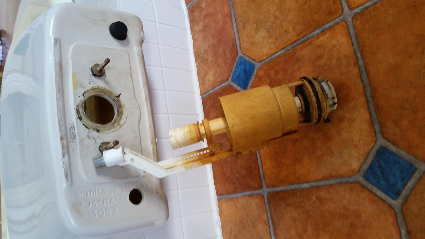

Greetings everyone. I'm writing from North Queensland, Australia. Currently renovating a 30 yo house. In one room there is an Armitage Shanks toilet that needs a new cistern outlet valve. The 'universal' 50mm outlet valve replacement available locally will not quite fit it. No-one I've spoken to here has encountered a cistern outlet hole this size and I've found no answers online. I have emailed Armitage Shanks UK twice with nil result.
The cistern is marked 'Armitage Shanks Australia 5062'. The size of the round hole in the cistern lid is approx. 27mm
Can anyone suggest where I might buy a suitable replacement part online, and exactly what I should ask for?

can you post a picture of the old cistern outlet valve.

Noted with thanks. I have taken the complete cistern to the local Reece plumbing place and they said "have never seen one that size" and offered no hope of getting a replacement part.
I have emailed Fixatap too by the way - also nil response. The main problem though is the hole at the base of the cistern - it's just a shade too small for the universal replacement part of fit into.
Noted with thanks. I have been on google and ebay etc but the problem is that (unless I have the specific part number to look for) then the odds are that a part will arrive in the post a couple of weeks later that also won't fit.

Could you not drill the hole a little bigger? You'd need to brace some wood inside to hold the pilot, Diamond core will do the job nicely.
Was involved in drilling some ceramic the other day, was surprisingly easy.
Fix A Tap have subsequently replied but were not able to offer any leads - they said all their outlet valves are the same size. I will go back now and ask them about part 229854
Interesting idea. I had just assumed that porcelain would shatter. There is a local company that drills holes in concrete slabs who might be able to tackle the job. I have their details already as I would need to drill new holes for waste and water if I send up having to replace the whole unit. Anyway sounds like a possible Plan B, thanks
Fix-a-loo have today advised that part 229854 has the standard 50mm outlet (i.e. it won't fit) Thanks anyway
Looking at the cistern again, I'm not sure it would be that easy as I think you would also have to drill the hole in the top of the pedestal, as the cistern sits flush on the pedestal.
