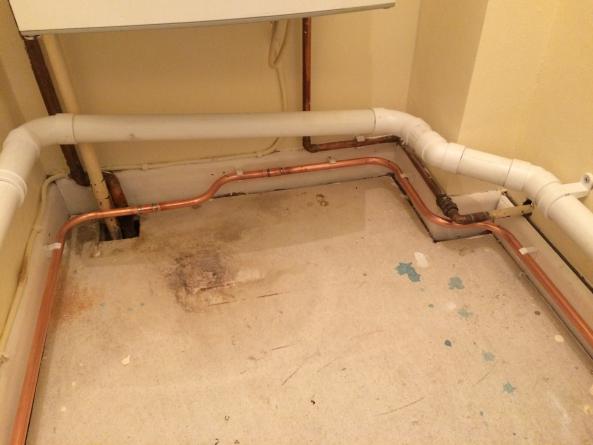

Here's some I done for a washing machine the other day (I never run out of elbows, honest) image.jpg
Jcsplumblng. That's a good photo , very impressive. No elbows so no cost . No leaks and less flow resistance. Regards nicolas
That looks neat.

i would have used an elbow on the right hand external corner and again round the pipe on the left and bent the rest. two couplings either side of a offset looks wrong
Same ^^^
