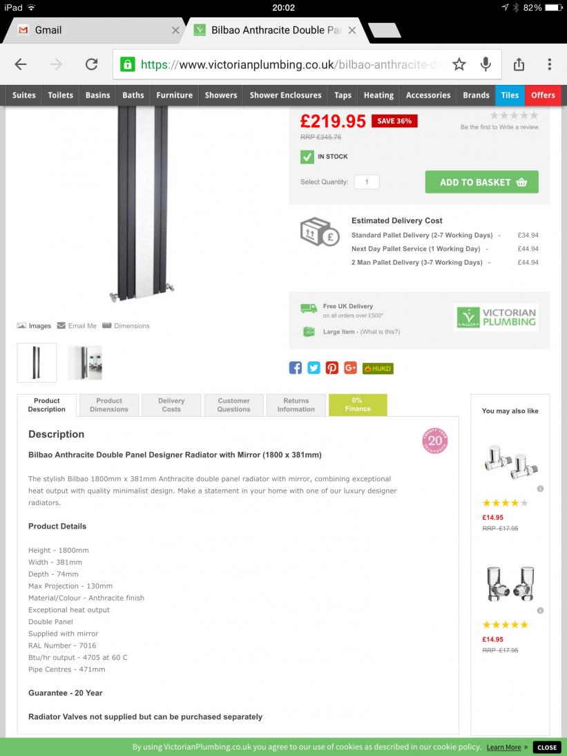

Hi. Thanks for the swift reply. Bilbo Anthracite Double Panel designer radiator with Mirror 1800x381. It's fitted to an outside South facing wall. image.jpg. This is one btu calculation with the dimensions.

They gave the information you required ie 4705btu @60ºΔT which means 4705btu at a mean water to air temperature of 60º. This is not a viable way of calculating anything as generally the air temp will be 20º+(bedrooms used to be 18º but these days a bedroom is expected to be as warm as a lounge) and the mwt will be anything between 76 (max unless poorly installed) to <50º with a condensing boiler. This means your ΔT is between 30 and 56 and the lower the ΔT the lower the output.
If you contact the manu they will give you correction factors that are applied to the given outputs to give you the outputs at any given ΔT eg at a ΔT of 50 the correction factor may be 0.78 so the 4705 btu drops to 3670btu

Assuming its a std efficiency boiler, set at 74º, the MWT at the radiator in a perfect world would be will be 69º but in reality it will be a wee bit lower, so lets call it 67ºC
If you want your room to be 21º this means the ΔT will be 46ºC
Multiply the output by the correction factor
4705*0.71 = 3340btu (just under a kw which for easy thinking is like one bar of an old electric fire)
