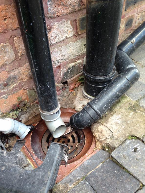

Hi - I moved into a new house recently (quite old - built in 1915). There is one bathroom and the waste from the kitchen sink, bathroom basin and bath drain into a gully outside the kitchen. The toilet waste goes into a vented waste pipe which also has dishwasher waste attached.
The set up looks like this:
The central pipe takes both guttering and bathroom waste. The left pipe is kitchen sink waste (inc washing machine) and the bottom right pipe is another gutter. The vented pipe is behind it.

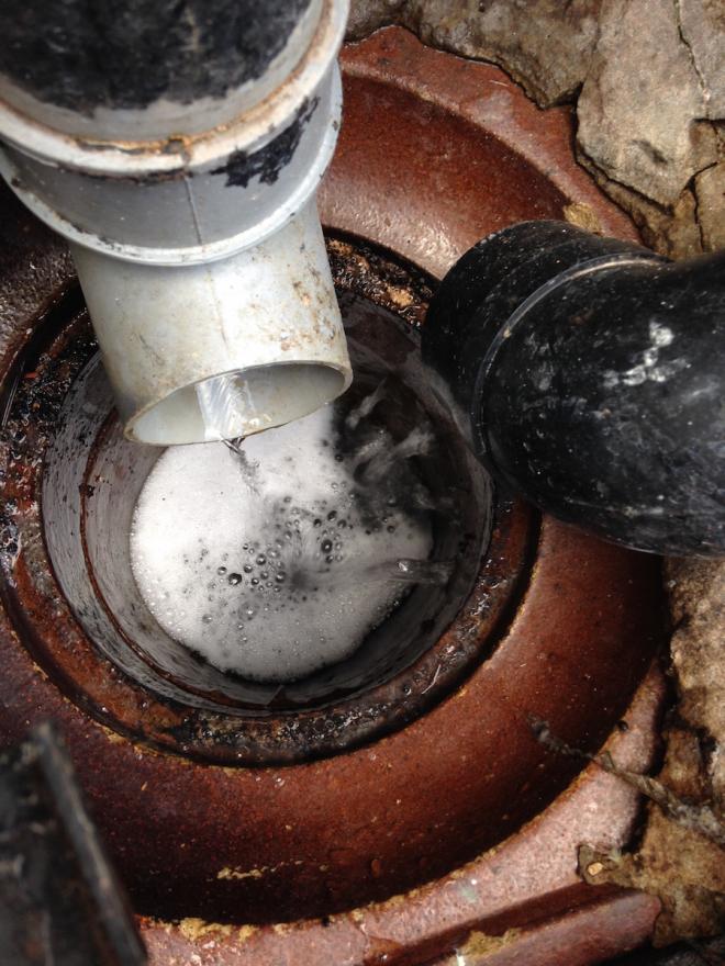

I noticed there was a bit of a smell outside when the toilet is flushed. When I removed the cap to the gully, I noticed that when the toilet is flushed, water flows into the gully from a small slit on the right:
Sorry the picture isn't great - I had to flush the toilet and then run downstairs before the water finished draining to get the picture. Hopefully you can see there is water seeping through this small slit - presumably from the waste stack. My first question is, should this be happening? The small slit where the water is coming through seems like it's part of the set up, i.e. not a crack that's appeared. I know very little about outside drains so I'm not entirely sure what's normal.
If this set up is correct, what might be causing an odour?

looks to be a botch job when put in originally and made worse over time. You will probably find the soil pipe is split somewhere and running into the ground and drain so would be best to get it investigated. Water can remove a lot of soil over time causing a bit or worse a large sink hole, doesnt do your foundations much good either
Agree with Lame, you really need a drains guy out to sort this problem. The soil probably meets up with the grid after the trap i.e. a combined drain, the trap is there to stop smells but the soil is likely broken underground and causing the issues Lame mentions above.
Looks to me like the new plastic stack has been connected to the old soil at floor level,
Most likely the old soil pipe has cracked, id get a plumber round to
Replace to stack from ground level down and fit a new with a back inlet gully that will take the rain water and neaten up the gully a bit
Yes as above. Get it all dug up and redone properly.
definitely going to need digging outlooks like its been raised to meet the ground level at some time
Thank you for the advice - will get it looked at.
