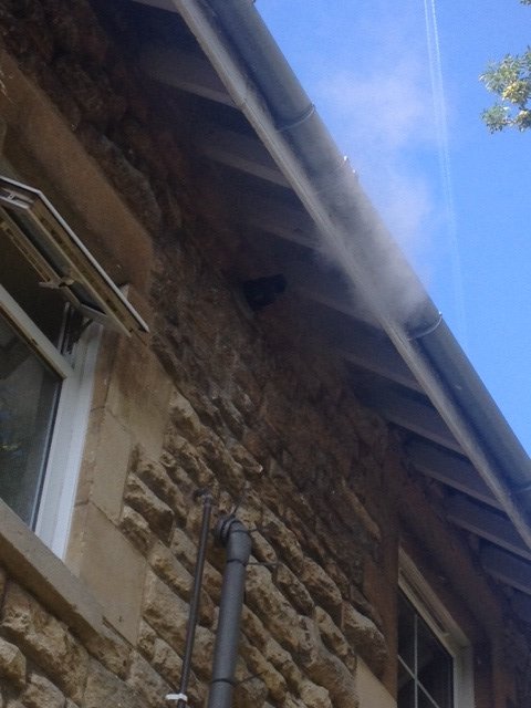

This is one i saw a couple weeks back!
Been installed for about 7 years directly within the eaves!
