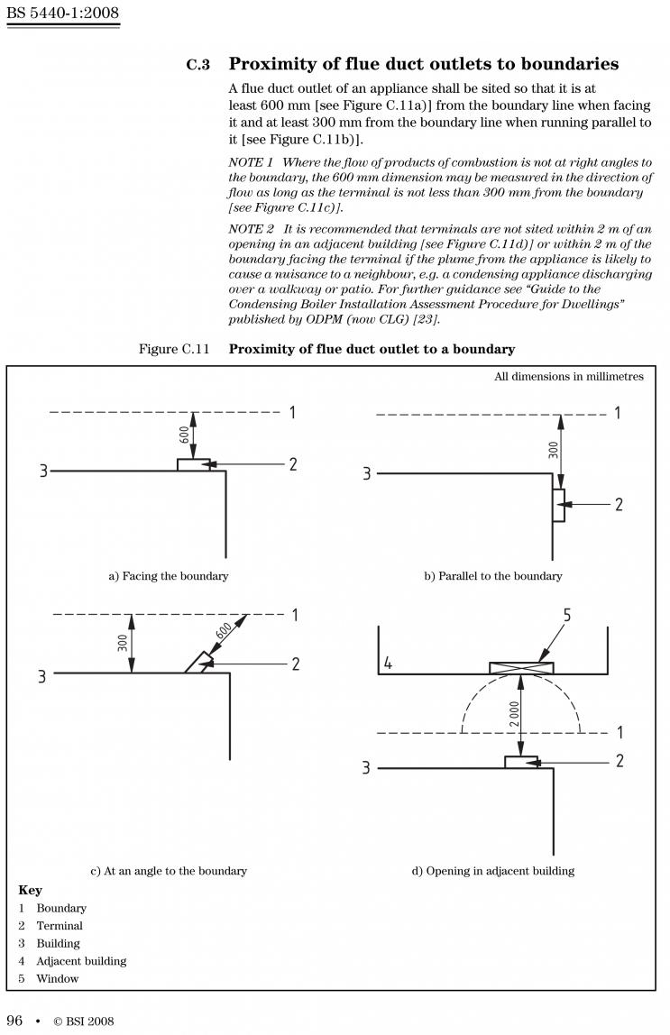

Surely if its not allowed to put a flue within 1200 of a cooker hood for safety reasons then it would be common sense not to fit the cooker hood within 1200 of the already fitted flue, I certainly wont be doing it..
Alex, I know the term to term but where does the 2000 come from?
Building regs dimensions are used in the M.Is, so I would go with them.
B.S is a recommendation only.
Sorry the 2m is a recommendation is what I meant

MIs mention to us:
BRITISH STANDARDS
Where no specific instruction is given, reference should be made to the relevant British Standard Codes of Practice.
BS 7074:1 Code of practice for domestic and hot water supply
BS 6891 Installation of low pressure gas pipe work up to 35mm (R11⁄4 )
BS 5546 Installation of gas hot water supplies for domestic purposes
EN 12828 Central heating for domestic premises
BS 5440:1 Flues and ventilation for gas appliances of rated heating not exceeding 70kW (net): Flues
BS 5440:2 Flues and ventilation for gas appliances of rated heating not exceeding 70kW (net): Air Supply
BS 7593 Treatment of water in domestic hot water central heating systems
BS 6798 Installation of gas fired boilers of rated input up to 70kW (net)

An update if anyone is interested, the boiler is a Main 30 ecotec elite, I dont know the install date, the boundary fence is 600mm from the neighbours property and the flue extends 580mm straight out horizontally from the neighbours wall with the customers house about 500mm away on their side. I have a current version of gas safety on site guide (currently training to become GSR) so the flue is wrong as I see it but how long has this measurement been a requirement. I dont want to tell the customers neighbour their flue is incorrect if it was okay at the time of installation.
from the face of the wall (neighbours where the boiler is located) it extends 580mm?? and chance of a pic
