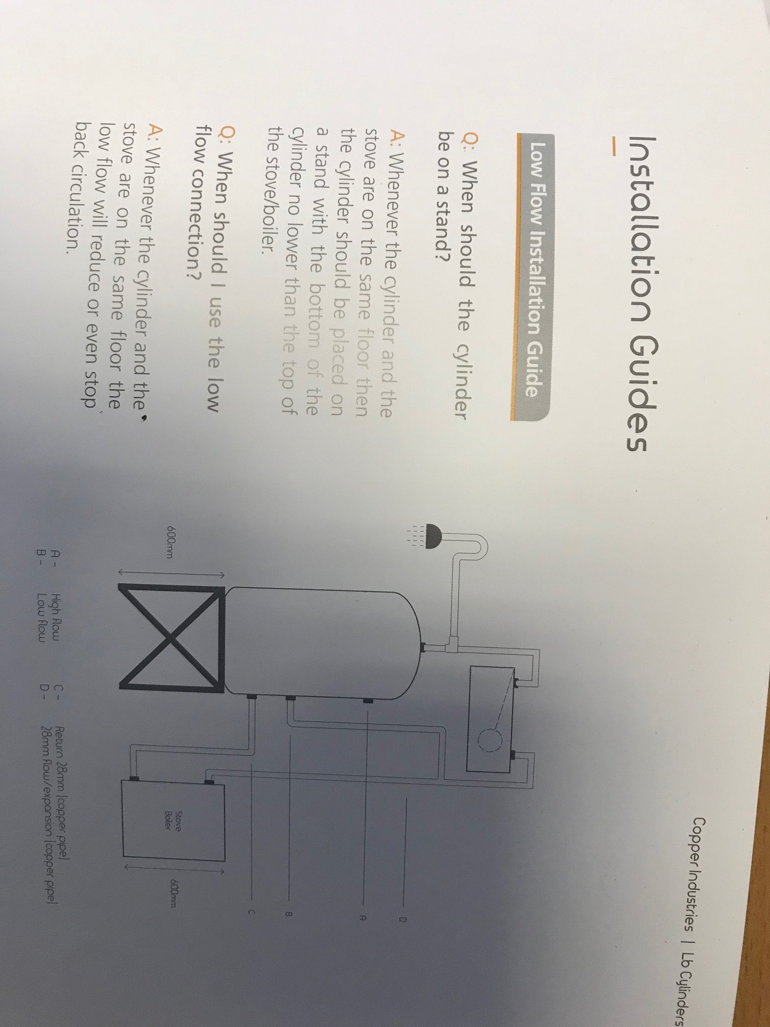

One would think so yes but the maxipod thermal store shows the flow rising up, then down to the cylinder, I wonder does this increase the mean circulating height between the boiler and cylinder or just helps to prevent reverse circulation.

The gravity circulating head can be calculated if you know the head (height between flow & return), length of pipe run & the fittings to be used.
It is all about the frictional resistance so if you can use pulled bends &/or swept fittings this will help greatly.
And the greater the circulating height, the greater the circulating force. (circulating height is the mean distance between the boiler/stove flow&return and the cylinder flow&return,
I took these temperature readings (cold cylinder) many years ago from a stove where the cylinder was ~ 15 ft above the stove, if the calcs are anyway accurate it just shows how small the circulating force is, 0.008M in this case and as you say, how important it is to have as low a frictional resistance as possible with proper fittings and piping diameters.
