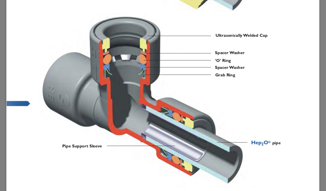

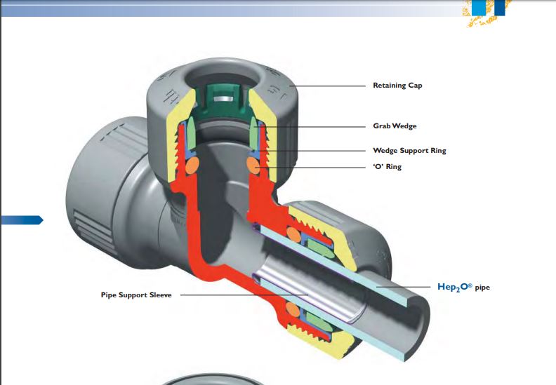

The old Hepworth grey fittings with metal grab ring had the O ring on the water side in the demountable Hep fittings and the opposite on the slimmer non demountable fittings.
