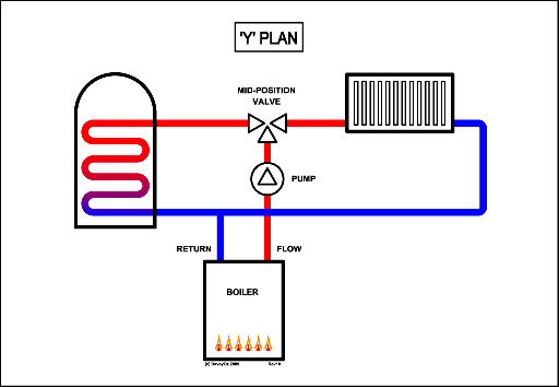

In my other property i have an old Y-Plan open vented central heating system, (Baxi Back Boiler). My tenants have the hot water on constantly (Gas) on the timer with the heating ( Rads ) as they always like to have hot water on tap
The 2 Hot water on off cycles of the timer is not enough.
( I know need a combi boiler )
Now this situation causes the following problem.
As the tank stat triggers a demand for hot water wile the heating is on ( Often happen ) the motor valve goes into mid position to supply hot water to the cylinder and the radiators
But as the supply to the Hot water tank is 22mm direct back to the boiler. This causes all the rads to go off or nearly off as there is far more back pressure on the 15mm radiator circuits than the 22mm Hot water Tank and return to boiler.
So im my mind the hot water is just taking the path of least resistance back to the bolier and heating just the hot water.
What advise can you give.
The layout is just standard simple layout with 8 radiators
Richard
No there is not and i did think about this but i was unsure if this was a std practice
Where would this be fitted on this basic picture

On the return after the cylinder
Would this balancing vale be in seiris with the 22mm as a restriction to the return flow?
Like a gate valve sort of thing ?
Or is my understanding incorrect ?
Regards Richard
gate valve on the return as it exits the cylinder in a perfect world it would be a locksheild gate valve
Thanks Steve for the advise, I need to brake into the system anyway to change a rad so i will add one at this time
