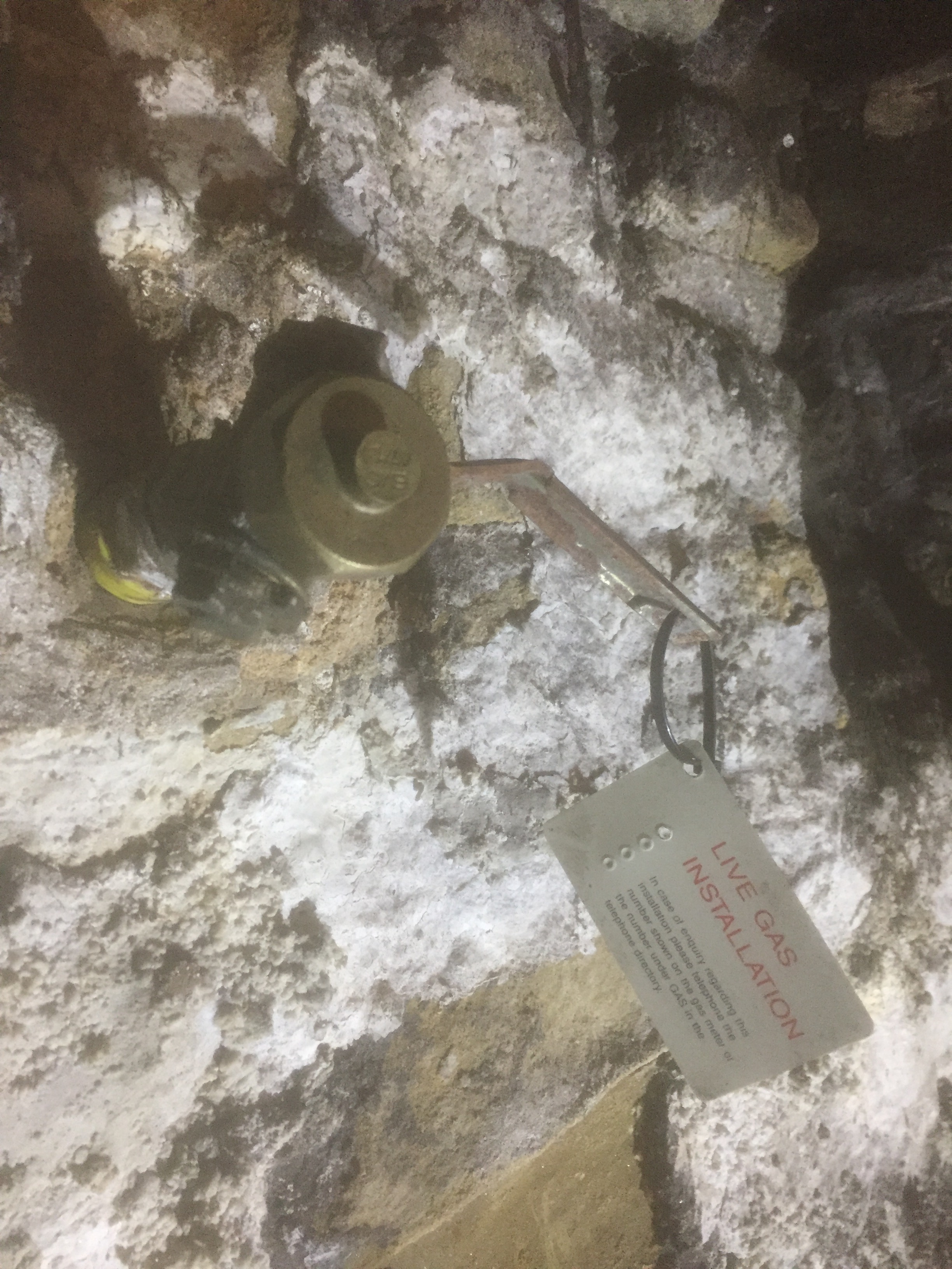

(3) Where a primary meter is removed, the person who last supplied gas through the meter before removal shall—
(a)where the meter is not forthwith re-installed or replaced by another meter—
(i)close any service valve which controlled the supply of gas to that meter and did not control the supply of gas to any other primary meter; and
(ii)seal the outlet of the emergency control with an appropriate fitting; and
(iii)clearly mark any live gas pipe in the premises in which the meter was installed to the effect that the pipe contains gas; and
(b)where the meter has not been re-installed or replaced by another meter before the expiry of the period of 12 months beginning with the date of removal of the meter and there is no such service valve as is mentioned in sub-paragraph (a)(i) above, ensure that the service pipe or service pipework for those premises is disconnected as near as is reasonably practicable to the main or storage vessel and that any part of the pipe or pipework which is not removed is sealed at both ends with the appropriate fitting.

I think they're looking at 3b.
Is it over 12 months since a meter was attached to the service ?
they carnt do what they want with it , they also have to comply with the law
They can as it's within the law, you've told them you don't want gas anymore so they've removed the meter and capped the service and now there disconnecting your supply
All within there right to do so
