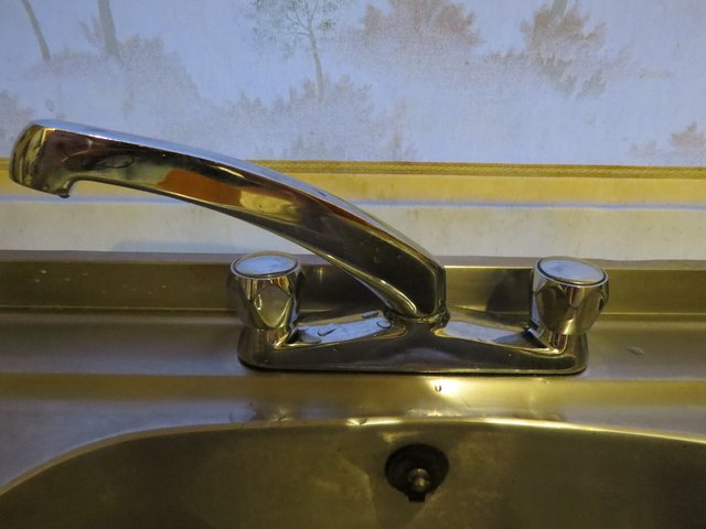

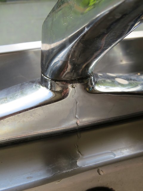

After several days of no leaking water I think I have found the bizarre cause of these little leaks under the sink - please see https://i.postimg.cc/7YgHGZMx/IMG-0585.jpg
The centre mixer cannot be removed as far as I can tell and has a little weep after tap used; tap turned off but retained water held above leak point in mixer by gravity. The foamy/rubbery gasket between tap and sink is absorbent, so must have been sucking this water in and somehow feeding it past the tap threads.
I had a bit of clear Stixall left so just used it to seal around the base of the tap. Leak free now:)
No grub screw on the deck behind the central swivel that you could remove to allow you to pull out the swivel and replace the O ring seals?
Would have been good to take a look at the 'o' ring but this tap does not seem to facilitate dismantling in that area. No grub screw as a lot of similar taps and no other fixing apparent.
The water was coming from that swivel junction in small amounts, limited by the small amount left/held in the tap itself after use. This water was being absorbed by the washer between sink and taps and then somehow, capillary action or similar, dripping off the underside. Sealing the base of the tap, whilst a bodge has resolved the issue.
